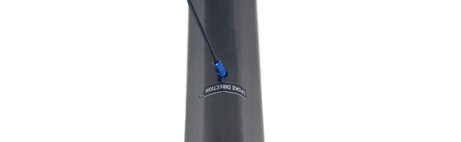

New one on me. Just got a set of Light Bicycle wheels. On the rim by the the valve hole is a label saying 'spoke direction'. Looking down on the wheel with the valve hole at the bottom it would be from left to right , slightly pointing to the rear. Both wheels have it, even the front which is radial pattern. Anyone know?

The holes are angled for left and right flange.

Yes I understand that, but the wheels are already built and I still don't quite see what that label tells you.

I guess it tells you that they don't take those labels off after they've laced up the wheel.
Or they want to advertise that the holes are angled, it is actually a nice touch.

https://www.lightbicycle.com/support/user-guides
• Follow the spoke direction shown on arrow sticker.
The rims have angled nipple holes that alternate left/right/left. Please lace spokes in the correct direction to avoid spoke hole damage. The direction is shown on arrow sticker near the valve hole.

Could do with that on the rims I buy. Due to my disregard for detail I have laced up wheels at least twice with spokes in the wrong holes and had to redo the whole thing...

+1 for wanting to see that on more rims, or a label to say it doesn't have an offset. Also would be nice to see all the stats (especially erd) written on the rim. Some do this but not many.
