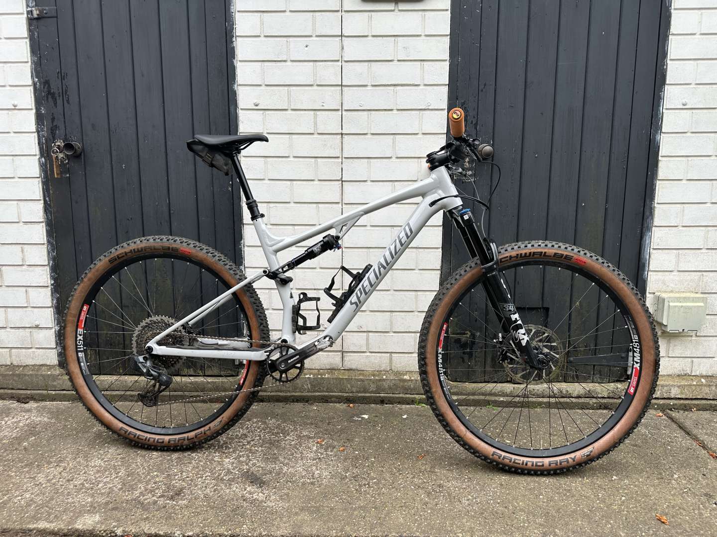

Had mine a few weeks now, XL size Chisel FS base, it's 15kg with pedals and bottle cages etc
I'll be making some upgrades over the next year, starting with those forks, I weighed them at just over 2.5kg and the cassette, it's 711g (will be going on the kickr though so not a complete waste).
Initial thoughts are that I want the bars lower (stack is higher than my XL sonder Evol) and the grips were too thin for my taste. Just need to put the miles in now.

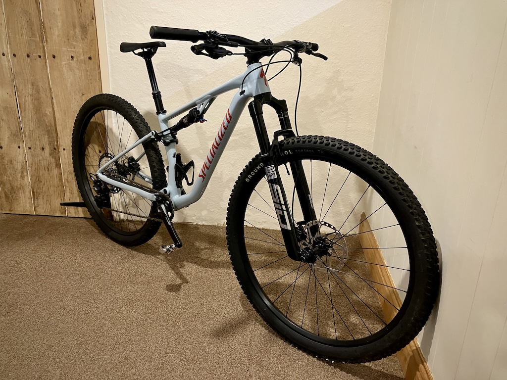

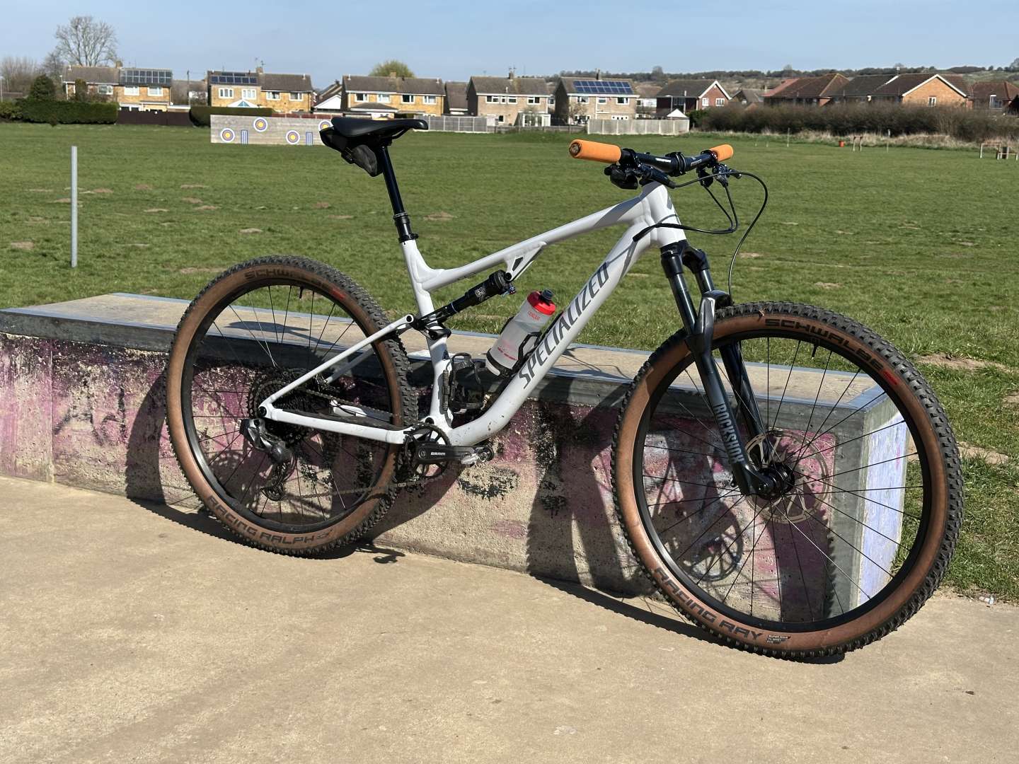

Got myself a base Chisel FS Shimano in August last year, and covered 200 miles on the stock bike which (in size S) weighed 14.4kg with pedals and one bottle cage. Here it is in stock form:
I decided to take some weight off, and improve transmission etc. Opted for a 2021 SID Ultimate Raceday fork, which shaved 1kg off the front. I then went for an XT drivetrain which shaved 400g off the bike. Both upgrades were worth it. Here's what it looks like now at 13kg after covering an additional 50 mies:
Going for the 'comp' is a very sensible option. It's already lighter, has a slightly better drivetrain, better fork, and a shock that can be serviced in most places. There aren't many places that will service the X Fusion O2 Pro rear shock - plus if you want to tune it, I'm not sure the knowledge or parts are out there. The comp is worth the extra £700 if those things matter to you. A few things to point out:
1- Base 'Shimano' model isn't totally Shimano - cranks and BB are 'Prowheel' branded. YMMV as far as getting a replacement or different chainring for it. Going to a full XT drivetrain, it's a lot quieter/smoother so I'm pleased.
2- Switching to the SID forks required a new front rotor - stock is 160mm (despite what the sales blurb claims), and I had to replace it with a 180mm rotor.
3- Base model brakes are fine, but not sinter pad compatible. Apparently, to go sintered, new calipers and rotors are required. Bear that in mind.
4- Headset lasted 200 miles. No rubber seals on the top or bottom. I replaced it with an FSA headset and keep an eye on it. Could be user error, but worth mentioning.
5- Rear axle has come loose once or twice - not sure why. User error? I have greased it etc to avoid corrosion, so I might try something else.
6- VERY easy to setup as tubeless. It took minutes using a track pump, and has been trouble-free.
Having had 13 years off riding a MTB, previously owning a HT with only 90mm travel, I can't give you any realistic feedback on how it rides/performs compared to other FS bikes.
So far, it's been great though - but it'll take time to get used to how it performs going up VERY steep stuff. I might change the position of the flip-chip and/or bars for a better position when climbing.

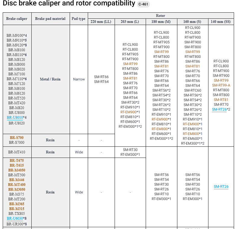

It's just the rotors usually.  You might die, maybe from brake failure, maybe from something else.  IIRC they're just not as hard as or ground flat after cutting like the more expensive ones so wear faster with sintered pads or may not stay as straight.
That's exactly what I thought - can't imagine why a caliper wouldn't be sinter compatible, unless it's something to do with the seals? I'll look into it again.
My Vitus came with 4+2 pot MT500 brakes, I've paid no attention to any warnings about pad types if there were any.  Although I did swap the rotors as I had some nicer ones in the spares box.
I'm 99.99% sure the warning only applied to the rotors.

Just an update - after calling my LBS and searching for answers, here's the Shimano compatibility chart:
https://productinfo.shimano.com/en/compatibility/C-192
There's no sinter option for the BR-MT410 calipers... despite the marketing bumph suggesting there is. I'm not picking on this particular retailer - various web sites suggest they are compatible... but it conflicts with Shimano's chart:
https://www.tredz.co.uk/.Shimano-BR-MT410-Deore-2-pot-Calliper-without-adapters-Front-Rear_234186.htm
So it looks like there's no OEM offering... it's either aftermarket, or a different set of calipers.
Another reason to go for the Chisel FS Comp (avoiding the base spec Shimano) - it comes with the M6100 series brakes (various pad options available from Shimano) and absolute clarity regarding the use of sintered pads. 👍
Posted : 26/02/2025 12:21 pm
Posts: 258
MT520 & MT420 4 pot callipers can use resin and sintered pads.
MT410 & MT500 are resin pad only. Shimano resin only callipers use a wider pad than the callipers that use sintered pads, these are paired with rotors with a wider braking surface. Shimano do not make any sintered pad compatible rotors with the wider braking surface.
hmmm, I'll have to go check my bike, I'm 90% sure it's a MT420 front and MT410 rear.
And I'm running RT86 rotors.
I'm now torn between condemning Shimano for creating an incompatibility minefield and saying it'll be fine as long as the rotor arms don't wear.

Shimano Calliper Pad Rotor Compatibility
I didn't know about narrow and wide pads and bought narrow pad rotor but I had a wide pad calliper. I've probably ridden about 500 miles and can see that pad is wearing unevenly and the rotor is wearing on the spider as well as the braking surface. I know I should change the rotor to the correct one.

Posted by: cerrado-tu-ruido
Thanks - so I'm not going mad. Disappointing that many retailers are copying and pasting product descriptions (not sure what the source is) which is misleading.
So the new question is:
Are BR-M6100 calipers compatible with the 410 levers? If yes, it should be a cheap and easy way to get into the 'narrow' ecosystem (more rotor and pad options).
Posted : 01/03/2025 5:49 pm
Posts: 258
Posted by: Oms
Yes, same fitting at the calliper. It's SLX and above that have the banjo fitting.
Thanks - got the calipers on order, as well as a 'narrow' type disc for the rear (I was forced into a 180mm front disc when I upgraded to SID forks). Hopefully I get away with the same hoses - stock hoses with the 410 series brakes have a wider internal diameter (more expansion under pressure)... but I am light. 🤞

Just a little update:
-I fitted M6100 calipers (with sintered pads), straight swap with the M410 calipers. Quite happy with the set - thanks cerrado-tu-ruido.
-Turns out the rear M410 caliper was leaking - appears to be where the two halves join together, though I'm not sure (brake hose wasn't exactly torqued from factory, which I realised upon removing it).
-Something to note: I think there are two versions of the SM-RT64 Centre Lock rotors? 'Deore' comes with an internally splined lock ring (for QR type wheels?); 'SLX' has the externally splined lock ring? Regardless, it's all sorted.
-Bars for my S size bike were 770mm (as I measured them) - trimmed them to 740 after experimenting with holding the bars in different positions.
Getting there slowly but surely. 👍

Finally got my C2W voucher at the end of Feb.  Bike arrived last week.  Ridden it a couple of times.  Seems like a good all round bike which is what I wanted.
Fitted my Hunt XC wheels yesterday.  Hasn't shaved off my weight.  Its 14.56 kg which is just under 32lbs.  Thats a size Large.  Other than forks I don't think it will be easy to save much weight.  Ideally I'd like it to be under 30lbs but the Recon forks feel quite nice.  However I do plan to fit some SIDs when I find some

Two more outings last week and one so far this week, matching rear brake has been fitted now with a 180mm rotor. After so many years riding overbuilt trail bikes I’m falling head over heels for this bike, the handling is brilliant and it just wants to go fast all the time.
I definitely want to get some shorter cranks, most likely 170mm, a fair few pedal strikes on anything vaguely rooty last week.
