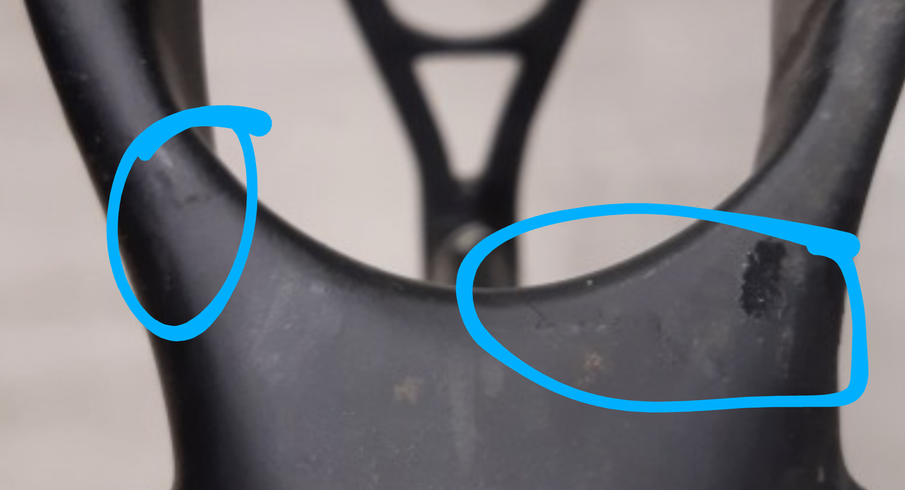

Hi all!
I recently bought a second hand specialized stumpjumper carbon 29er as an unfinished project.
The thing is, the rear wheel that was with it (135mm qr) doesn't fit propperly between the dropouts i would say.
I fitted a 130mm 27.5 wheel and this fitted great.
So my question is, did specialized make carbon 29ers with a 130mm dropout?
I don't feel really comfortable just forcing a 135mm wheel in there and can't find any 130mm rear 29er wheels.
Curious about your ideas,
Dennis

Could it have been subjected to a wonky repair? Can you check the symmetry of the dropouts? (Using the old bit of string round the headtube and back method)
Posted : 30/03/2022 8:37 pm
@dangeourbrain
Sadly you're right about the bottom bracket, the carbon is not in the best shape.
Wasn't mentioned by the seller (bought the frame sight unseen).
Posted : 30/03/2022 8:38 pm
@cookeaa
I'll have a look for that method and try.
Because the dropout at the drive side is not as smooth as at the non drive side.
This option did cross my mind, but i thought the rear fork and chainstay alignment wouldn't allow for shifting the dropout 5mm.

I was going to ask what the red bits on the inside of the chain stays were but looking at the image of the BB - it's that just top coat that's come off or something erm, less desirable.

I think it might be important to establish just why the Dropout width is 130mm not the expected 135.
Have you been back to the seller with to Question this?
They might have no clue (or claim not to) but it's certainly worth asking, I can't imagine they never noticed that MTB hubs don't fit in the frame.
dangeourbrain's observation of what looks like signs of damage at the root of the chainstays above is certainly worth closer examination.
it's (apparently) a decade old frame, there's every chance it got squished at some stage since it was sold and repaired, potentially by someone not familiar with MTB spacing(?!??).
Personally I would be slightly nervous about this apparent problem, Carbon frames don't just get 5mm skinnier they're either made that way (nothing online to suggest that was the case) or they get damaged and repaired wonky...
