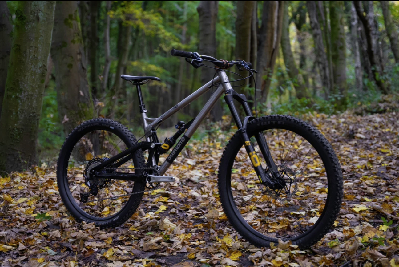

I'm actually in the process of going from an FS trail bike (2015 Stumpy Evo) to a "Hardcore" HT.
I'd just come to the conclusion that a decade old bouncy bike frame with even more dated Geometry wasn't really worth the effort/cost of maintaining (for me) Vs the relative benefits of a simpler, handling focussed HT which I can change later without too much fuss and no rear shock to look after...
In terms of parts to focus on, for me it's primarily going to be Wheels and tyres. I intend to build two different rear wheels one for "normal" use and one for "aggressive" use (i.e. uplift days and smashing through rocks), I am probably going to be Mulleting it to begin with so I can use the front wheel I already have and am pretty happy with in most use cases.
Fork is a Manitou Mezzer which is pretty light, and very adjustable in terms of both travel, damping and spring.
Weight of the chassis will be a big winner for me, a ~2kg fork with a ~2.5kg HT frame will always be lighter than the lightest trail FS frame.
Light wheels are a bonus, but I wouldn't build down to a weight, I would build wheels (and spec tyres) to suit the application. If you are going to be mashing through rocks all day a sub 400g 28h wheel will only last so long especially on the rear.
Only other thing worth thinking about is Bars, comfortable bars in a width that suits you, but that's a very personal thing, similar goes for saddles or grips I guess.
Drivetrain and Brakes might get some cash splashed at them later, but it's going to be ~Deore-ish spec to start and I've no massive urge to upgrade while they're still working...

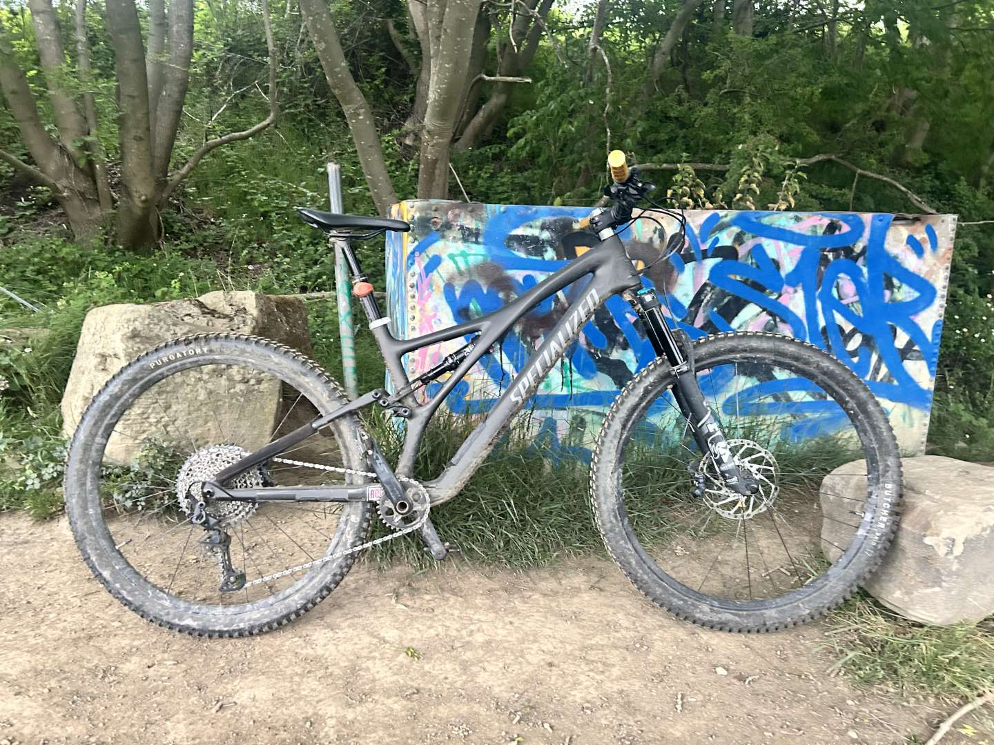

Spent the last few months drastically overthinking this exact dilemma, and this is what I bought at the weekend to hopefully fulfil the role...
My brief was that I didn't want a Downcountry bike, I didn't want an Enduro bike, I wanted something that with 2 sets of wheels could be entered into either an XC race (giving up a kilo or two granted) or an Enduro race (giving up a bit of travel but not much else) if required... Also important was a 35/36mm chassis fork, super efficient pedalling dynamics, as close to 13kg total weight as possible (this is 13.5kg stock, with some upgrades it won't be difficult to drop below that weight) and the ability to at least ride all the most gnarly trails I tend to ride confidently if not set PR's on them (where a downcountry bike would feel out of its depth and I would be backing off significantly).
I deliberated over all sorts of bikes in the 130ish travel category, but ultimately the Raze ticked the most boxes, the geometry is bang on for what I want in my size, and I was able to pick one up for a crazy price!
Next to personalise it... First will be swap the GX/NX out for some X01 Eagle I have spare, then work out what I'm doing with the brakes (definitely will fit a 200mm front rotor if nothing else, but debating swapping the G2's to Codes too). As for wheels, well the stock Crossmax XLS's look amazing, but I have a real wheel fetish and have 3 other high end sets to choose from too! So got some decisions to make... Also need to work out what to do re the fork, whether to upgrade the damper to GRIP X2 or just buy a cheap GRIP2 fork off Merlin and sell the stock fork on... Oh, and need to work out if I can fit a 175/180mm drop post or not, the stock 150 drop possibly isn't enough now that I have got used to more... Will also fit my trusted contact points and super fast rolling rear tyre along with a fairly grippy front.

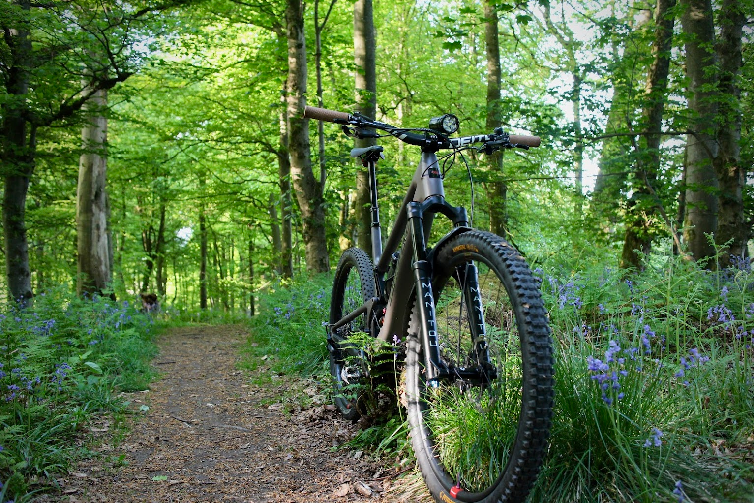

I’m another of the hardtail trail bike collective - to be honest it’s my unpowered do everything bike. Pipedream Moxie, great feeling big fork steel hardtail with what was once extreme geometry but now just seems normal (for a similar full-sus at sag.)
Lyrik RC2 160mm up front, you could go with 150 or 140 but I don’t see any benefit to less travel than that unless the air spring suits it and you like a firmer feel. If you’re lighter you could go down to a Pike / 34 (other brands are available). I like a better / more adjustable damper, I don’t think they’re too hard to dial in if you’re a bit methodical and then you can mostly ignore the extra knobs.
It’s got old Hope Tech 3 E4 brakes on 203/183 discs - 12 years and counting. DT Swiss XM1700 wheels - reliable, quite strong and not heavy. Hillbilly T9 Grid Trail front, Butcher T7 Grid rear with a Rimpact Pro insert. Full 29” btw. I’ve got tired of changing tyres for summer vs winter because if we have a muddy summer ride I need a really toothy rear to singlespeed the climbs and although the soft compound front helps more when it’s cold and wet and slippery it also feels really good being more damped when it’s dry and fast. And we don’t get a long window of hero dirt, it gets loose pretty quickly in the dry.
BikeYoke 185mm dropper (like the brakes, expensive new but good value over its lifespan) - go even longer if you’ve got long legs. Fabric Scoop saddle (I’ve not sat on a saddle I don’t get on with, must be lucky?)
Renthal FatBar Lite because 760mm fits though the trees and has some flex vs a wider bar cut down. Hope 50mm stem because I like Hope things but does it matter if it clamps properly and isn’t bendy? Hope headset and BB because I can ignore them for years and years.
It’s got SLX 165mm cranks and it’s singlespeed. If I lived somewhere flatter or much hillier, or rode more road sections I think I’d need gears, in which case I’d put on the XT 11 speed stuff I took off my ebike (I’ve got a tougher rear wheel coming off that when I mullet it so maybe I’ll set it up for the hardtail so I can put gears on easily - hurrah for external routing!) And DMR DeathGrips and Vaults.
Considering it has no gears and no rear suspension it’s not exactly light but it feels fast and fun!
If I built up a full-sus equivalent it would get much the same parts - maybe a bigger rear disc because the back brake on a hardtail does so little hard braking!

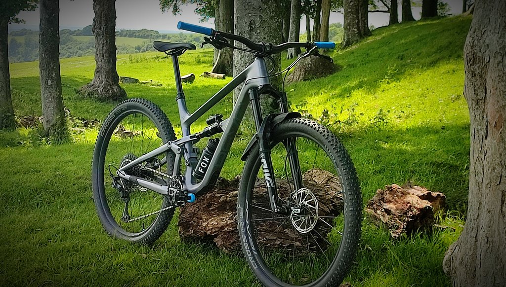

I am very confident that I have built the objectively perfect UK trail bike 😉
On a serious note, the target was 130/140mm, 13kgs (without pedals 🙄), maximum versatility (my only bike) and under £2k.
I obviously cheated by buying a used frame and fork (albeit very lightly used) and had to buy x2 Stif X01 groupsets to end up with a cassette that cost -£100 after selling the bits I didn't need, ie everything appart from one cassette.

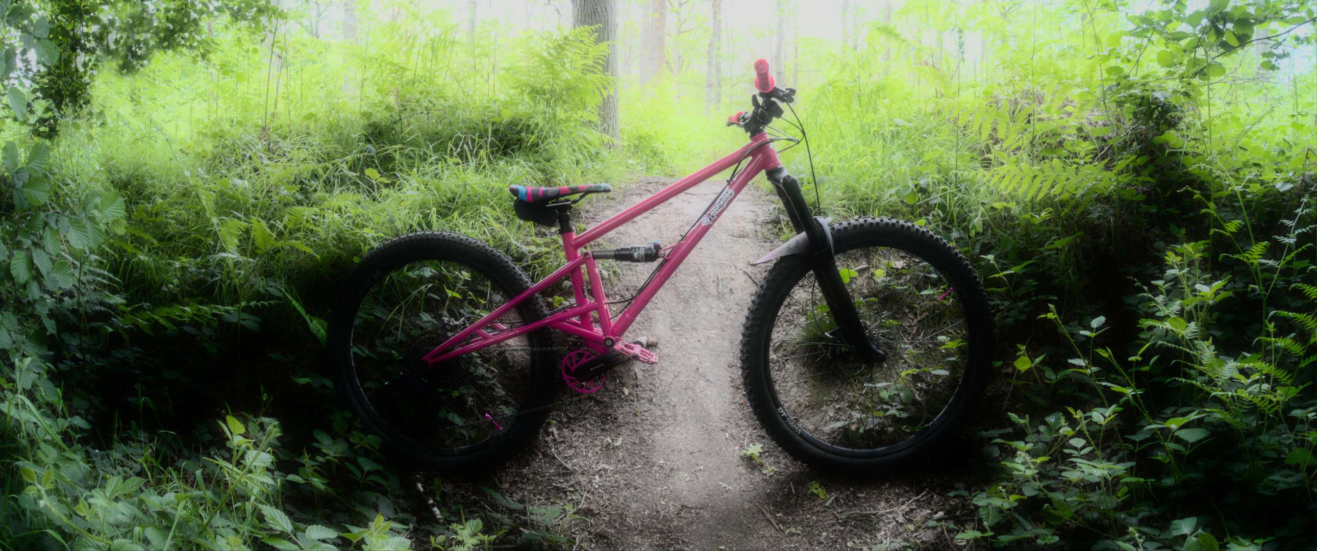

With all these references to 29", I'm beginning to wish I'd opted for that instead of the 27.5" from the CRC sale.
But its pretty much built, though health denotes I'm not going to be the rider.
Built with what I felt was reasonable kit, though it might be more enduro than trail.
The mega275 carbon.
Fox factory 36 160mm
Hope pro5 fortus 30(35 front) wheels
Fox transfer P/E dropper(Hope dropper lever)
Nukeproof flatties
Hope 50mm stem 0d
Fizik something saddle
Sram GX shifter/mech/cranks/cassette
USE 2" carbon risers
Hope T4 V4
Hope 200mm vented F&R
All parts I got either in the CRC clearout, or from other sales, as well as price match. I've spent £2k to get it to this(every part bought brand new).
Being a complete bike tart, its the blue frame with orange decals, so the Hope highlights are orange or blue.

Posts: 6575
Reckon my Orange Stage 5 pretty much covers the brief. 135mm frame with 150mm Fox 36, Tech 3 E4 brakes, Fox dropper, Renthal carbon bar, Hope wheels with a Magic Mary / Nobby Nic combo and a load of Hope finishing kit.
I've ridden it from gentle XC to the harder Reds at BPW and everything in-between and it's been spot on. The sweet spot is trail riding though. Soon to be moved on as I've bought a more XC focused bike and plan to get a longer travel enduro thing to widen my options but for an all in one'r it has been hard to beat.
Posted : 16/07/2025 1:53 pm

 mboy
Posts: 12533
Posted by: kelvin
@mboy ... does that orange match Fox orange forks?
I believe it does yes... Certainly if it's not an absolute match, then it's close enough...
And I know what you're thinking, cos I've already thought it too...
Be an expensive upgrade path though, cos then I'd also end up with Kashima uppers which would need a matching shock and seatpost too!
Posted : 16/07/2025 2:48 pm

Posts: 7857
My 'big' bike and my 'trail' bike have very similar builds - just the frame rear travel is different (big bike is 160mm and trail bike is 120mm). I'm not fussed about weight too much and means I can easily swap bits around in an emergency.
160mm Lyriks with a Splug.
DT Swiss M1900 wheels. My tiny concession to weight is running WTB Vigilante/Ranger 2.8s instead of the Maxxis DHF 3.0 and Rekon 2.8 on the big bike.
Drivetrain is Microshift Advent 9 speed on a 165mm SRAM SX DUB chainset with a Works 32T oval and RaceFace Chester composite pedals.
Brakes are Magura Trail Sport with proper Magura discs. Ridiculous VFM.
Saddle is a DMR OiOi held up by a bargain Bontrager Line 170mm dropper.
'Cockpit' is as right old jumble - 35mm DMR Defy stem, 780mm BBB Ascension bars and Deathgrips.

Posts: 339
More great builds and ideas, thanks.  Nothing wrong with my Rhythm, but I’ve got a hardtail it can go on and do fancy something with a bit more travel and strength up front - the Mezzer sounds interesting.
My bike as it stands now, only changed the contact points from stock. I’ll look IMG_4796.jpeg into some of the other recommendations, bonus points if things come in silver.
Posted : 16/07/2025 4:43 pm
