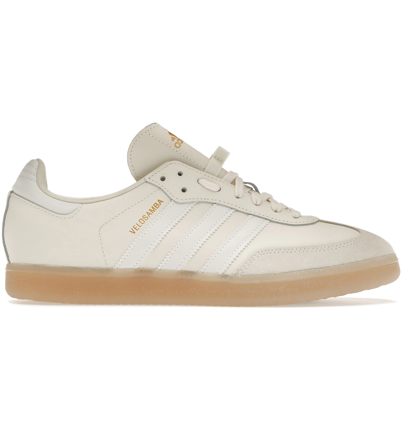

You can get Mallets of one flavour or another for closer to £100. I've been using them for years and love them. Dead easy to get out of, have plenty of float and whilst I don't ride as often as many, I've never had any issues.
The shoes I use with them
