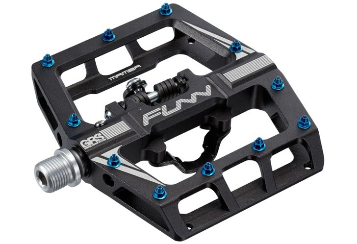

 Pyro
Posts: 2400
I use the Funn Mamba S double-siders, they're pretty good and work as a normal pinned pedal with my 5:10s when I need them to.
