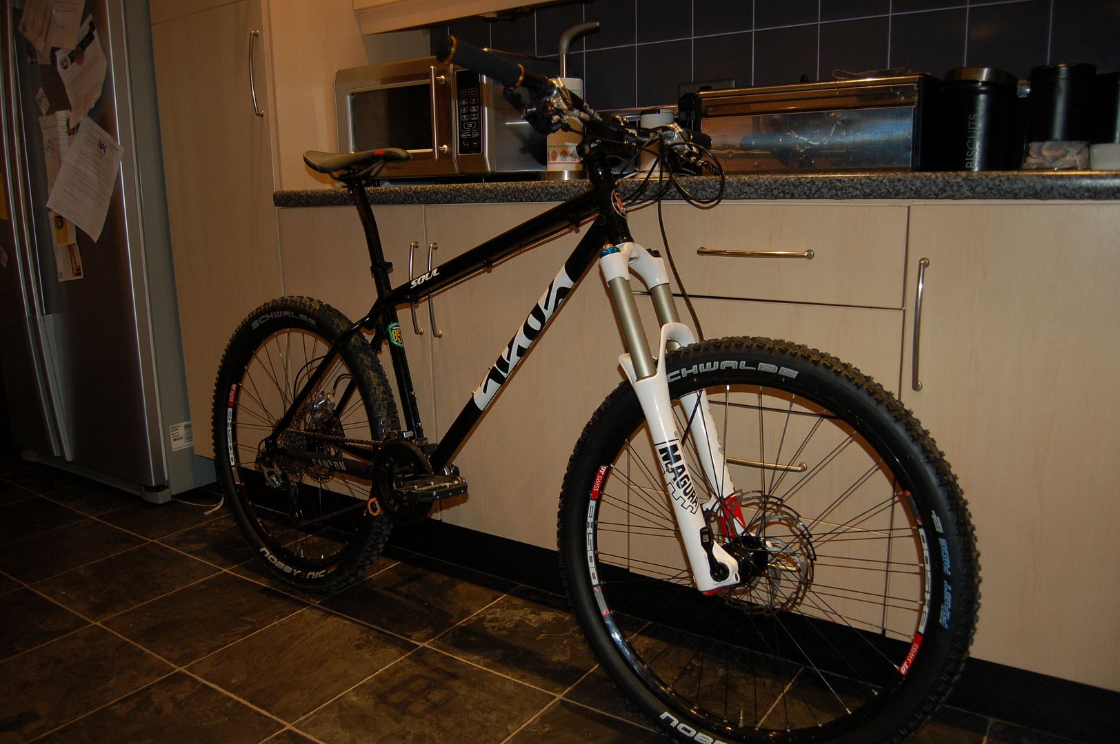

Posts: 3845
Well, here it is. Rides really well so far, running the 140 Thor sagged.
He finished building it yesterday.

Looks smart.
I ran my soul, briefly, with a Thor at 140mm but couldn't get the sag stiffness right, it was a bit "divey".
Front rotor looks to be on the wrong way around .....
I think you might be right..... teach me to check!

Posts: 3845
Just checked the rotor. It's a Superstar one, and has a directional arrow, which points the way it's mounted. Odd.
