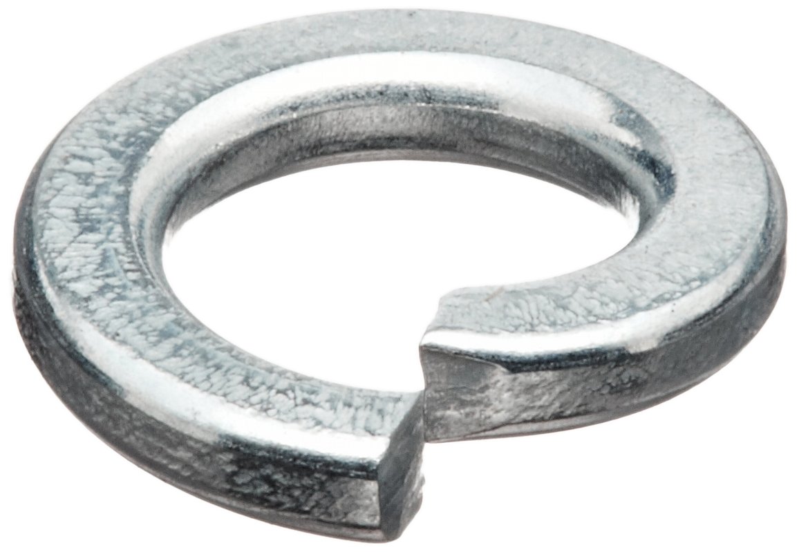

Did the same thing with cheap as chips alloy split washers, about 4 mm in using the original bolts!
Were free and are hardly noticeable behind the spider. Although that won't be the case for all cranksets.

An added bonus of spacing a chain ring in, usually means you can use the original chain ring bolts, when converting older non 1x cranksets!
