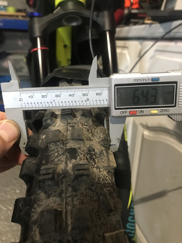

For reference here is my Wild enduro Frnt on a 30mm rim...
Posted : 14/10/2019 10:24 am
Sorry - page split has meant Mary picture and info is on page 1.....
So less than 2mm in difference between the 2.4 Michelin and 2.6 Mary.

I mentioned on another thread that I tried them on 25 and 30mm rims. On 25 the profile was nice, on 30 it squared off too much and didn't like corners so much, I imagine that on 35mm they are shite. I'm trying to find the source but I recall Michelin recommending a 25mm rim with 30 as the max; as 25mm is rather narrow these days I can see why people give them indifferent reviews as they are being used at the design limit. Same for a DHR2, if you run 30mm rims you should probably use the WT format rather than standard otherwise the knobs will be in the "wrong" place.

Supplemental info - the 2.6 Mary rolls surprisingly well. I thought it might be a bit draggy to push around but not sure I can tell difference from narrower version.
Posted : 14/10/2019 11:29 am
I think that’s because it’s not hugely different in size to the normall Mary, despite what the tyre size says. For me the knobs are better spaced, larger and just alround better on the 2.6.  I get more grip because I run lower pressure with an insert I get slightly less tyre role than expected.  Genuinely it’s a great tyre and seems to hold up better than the 2.35.  Would happily run another on my big bike if Schwable made a rear tyre that was any good or lasted more than a couple of weeks.  My OCD doesn’t allow me to mix brands on the posh bike...ok on the winter hack....
Posted : 14/10/2019 12:20 pm
