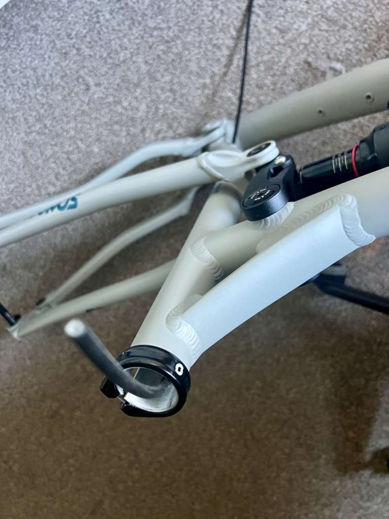

Hi, I just got one of the £350 eBay MK1 frames. The headset needs to be a IS42/28.6 | IS52/40.
Is that one of those where the bearings drop straight in the frame without needing any cups pressed in?
Also, can anyone recommend or know if it's possible to add internal hoses for the cables to reduce noise?
Thanks.

For the cables you can use this (also cheaper non-branded versions on eBay/Amazon):
https://www.bikeparts.co.uk/products/jagwire-internal-housing-damper-4-5mm-grey-1-5m?currency=GBP&variant=45336236261533&utm_source=google&utm_medium=cpc&utm_campaign=Google%20Shopping&stkn=a894e8283159&gad_source=1&gclid=EAIaIQobChMI6o_-2-n8igMVh4pQBh319DZyEAQYAyABEgIg7fD_BwE
For the headset I'm pretty sure you're right, should just be drop-in bearings and a top cover/crown race to cover them and the 'cups' are part of the frame but would need to see some pics of the headtube really to be 100%.

Posts: 125
Sure my bearings dropped straight in when i did the same thing. I'm running some thin foam tube over the cables internally, you have the little hatch on the bottom bracket for the cables? think it has three holes from memory so work out all cable housing lengths in advance, slide the tubes over then thread the end through the hatch/plate. Watch the little hex, rounds easy!

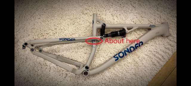

Posts: 2114
I started the build today.
Ran all the cables and hoses.
Stripped the 23 Big Al, the donour bike.
Couldn't insert the dropper which fits nicely without a cable but the outer snags onto something in the seat tube that chews the coating of the outer. Went through 3 outer cables with the same result despite "trying everything". I even bought some small round files to file any burrs that have been left after the hole was drilled (which I am pretty is the problem), but to no avail. There is a bend so I can't see from the top even with a torch light.
I contacted Sonder who sounded friendly but haven't come up with a solution.
Any ideas?
I know it was cheap at £350 but it's actually quite expensive as useless.
I seemingly bought the last one so not sure what's gonna happen. I bought bits for it, applied frame protection etc.. plus headset and new forks.
Tough situation. Hopefully they will do the right thing, whatever that is.
A bit pissed off by the absence of QC so apologies for the rant.
Posted : 27/01/2025 9:49 pm

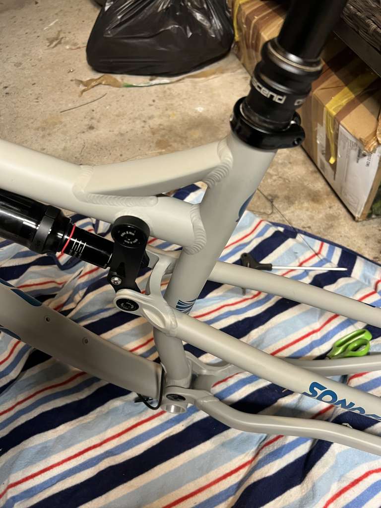

Posts: 197
I bought one of these too. After seeing your message, I grabbed some outer and it threaded through with no issues.
IMG_5112
Sounds like something is not quite right with yours.

Posts: 2114
^ Thank you. I can do that too but when inserting the dropper the outer snags as its trajectory is determined by the fact it's attached to the dropper as oppose to being able to go around any "obstacle".

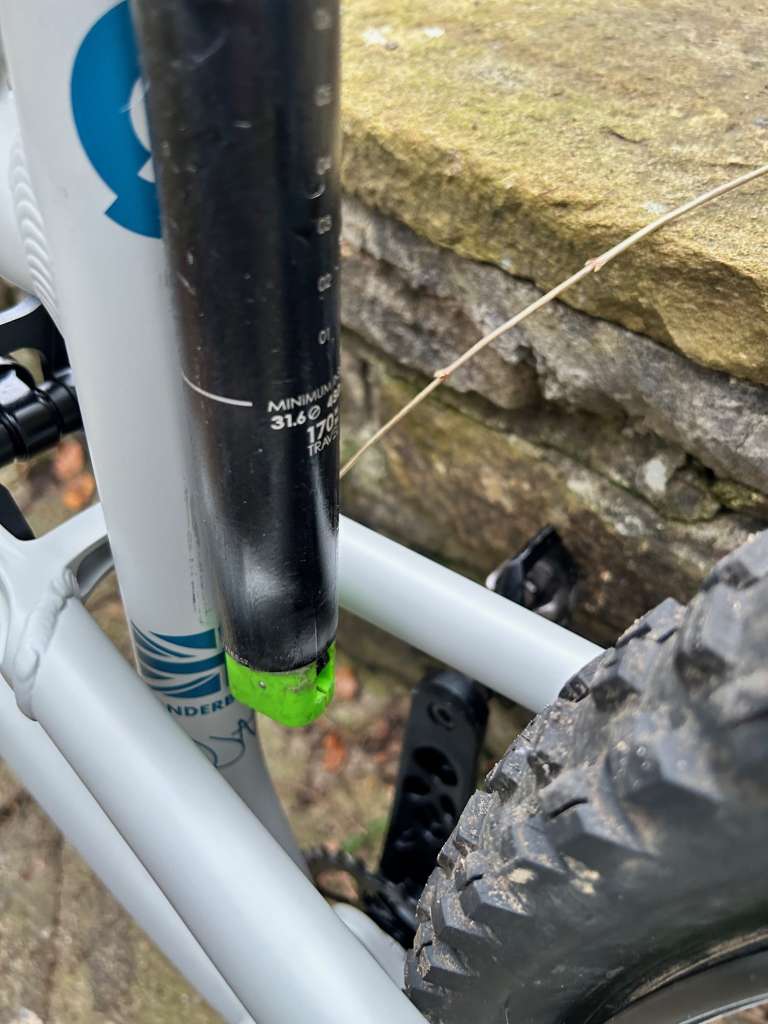

Posts: 2114
The problem is that this is what happens to every outer despite the utmost care. It literally chews the outer. I am pissed off enough like that without spending yet another £20 for potentially nothing. It's a clear warranty claim that Sonder is refusing to honour.

There can't be *that* much down there to cause this issue. What's the dropper and how far are you inserting it before this happens?
Are you really really careful with the cable coming out as you insert the post to make sure there is a small loop inside the frame and it's not rubbing on the frame exit hole?

Posted : 28/01/2025 7:43 pm
Posts: 197
I just fitted a Brand X 200mm with no issues:
IMG_5114

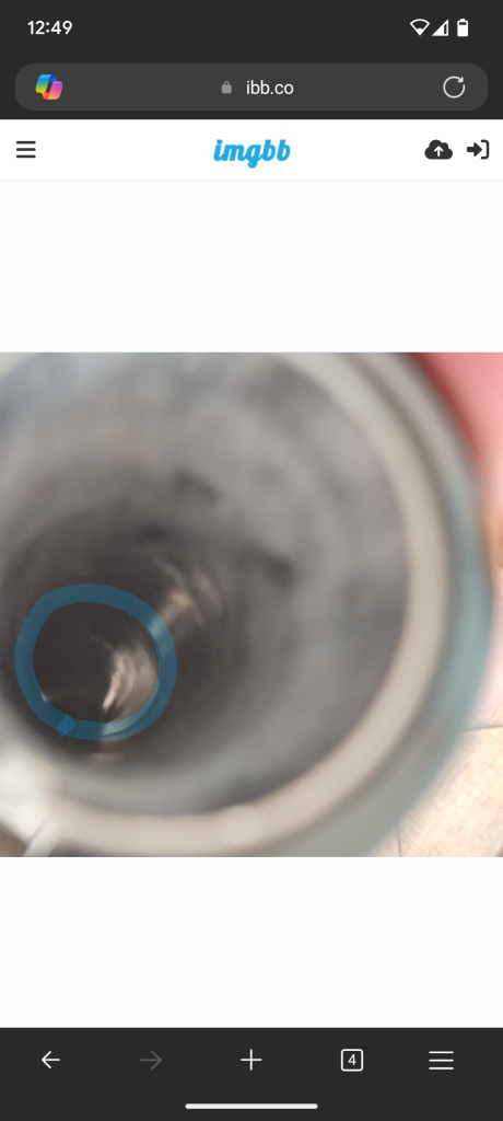

Posts: 8928
Looking down the seat tube surely you can virtually see the exit hole looking at the pics? Have you tried shining a torch down but also back through the hole, and vice versa, look through the exit hole whilst shining a light down the seat tube?
Try putting a ball of blu tac or something a bit smaller than the seat tube diameter on the end of some cable outer and see how far down it goes. Does it snag on anything before the seat exit hole?
Do you know of anyone with an inspection camera?

Posts: 609
Based on where the cable is getting damaged below the bottom of the seatpost, where on the frame do you suspect the outer damage is occurring?  It would appear there’s nothing on the down tube to catch on other than the exit port.

Posts: 2684
On my first sonder signal ti frame I had a similar issue. Must have been some sharp edge on the inside of the seattube or downtube hole (don't recall which). It didn't prevent it from getting through but shaved the outer when feeding it through. Wasn't an issue once installed but not ideal. I got a warranty replacement frame (for a different issue) which was fine.
Try removing the lower pivot so you can get access to the back of the hole to tidy it up.

Posts: 2114
Anyway another friend of mine has offered to give it a go. The outer doesn't just get scratched superficially (I always expect that), they get chewed up and gouged however careful we are, resulting in every attempt to end up unsuccessful at the lever. I have now gone through 6 outers.

Sl2000, the issue is the dropper itself won't go in because of the snagging, I am not too precious about the condition of the outer itself.
Dave_h. Thank you, some good points, which I all considered. You can raise doubts all you want, that's fair. I can be frustrated AND the mostly innocent party here, the two are not mutually exclusive. We will have to agree to disagree on the relevance of the sales channel and price here.
On a more positive note, I will try to wrap and super glue some thin emery cloth to an  outer to run it up and down. Just thought of it last night.
Posted : 29/01/2025 7:51 am
Posts: 2191
I don’t think you mentioned that the dropper itself won’t go in, it read as if it was just the cable snagging when you do.
You mentioned it happens once you push it in four inches, if that’s the case you would be able to see what’s causing it surely?
Posted : 29/01/2025 7:58 am
Posts: 5055
Based on your numerous attempts, how far in (from the bottom hole) do you estimate that the cable outer is getting snagged?
And IME it takes a hellva pull to damage an outer like that - if you're not happy then just send it back and get your money back.

It looks like the curve on the seat-tube is going to make the angle the cable exits the tube very, erm, 'snaggy', if you try to push it through from above, which it sounds as if you're doing.
Can you not, if you haven't already, feed it through from below then connect to the seatpost before very carefully manipulating the cable to minimise catching on the exit port as it feeds through. Presumably that's what's causing the outer damage? Sounds also like the more flexible, thinner cable suggested by @singlespeedstu above might help.
Or finding a way of smoothing the inside upper edge of the port, though that looks fiddly.
I guess the other option is that something sharp is obstructing the tube, but that seems unlikely, it being a tube and all.

I don't think I am very lucky. The snagging is still present.
To minimise the risk of snagging, I ordered a 170mm dropper. While I was at it, I ordered a 31.6 as my longer one was 30.9 with a shim.
It doesn't go in. This happens (used a 31.6mm fixed post for illustration).
No amount of filing makes any difference.
No idea if related to the initial issue but I don't think so. It was just hidden by the smaller diameter. Video:

No the issue is lower than that at 18.5cm from the top of the seat collar. I *might* be able to see a dark spot in the seat tube now. Not sure at all, but it is very small yet much darker than the surrounding silver aluminium. It looks a bit like if a bit of liquid metal was splashed there and cooled down in situ, if that makes any sense. Will try and do more filing in the morning lol.

[url= https://i.ibb.co/602wWfYf/IMG-20250202-112544.jp g" target="_blank">https://i.ibb.co/602wWfYf/IMG-20250202-112544.jp g"/> [/img][/url]
What do you guys see?
I'll take the frame to the shop tomorrow for a 4th opinion.
Posted : 02/02/2025 12:42 pm
Posts: 2684
Looks like quite a prominent lip. Can you see and feel it catching with a long thin tool of some sort?

My Large discount Cortex is probably going to struggle with my 170mm dropper.  I get 22cm post below the top of the seat tube before it won't go any further.   It looks like it's slightly above where the bend in the seat tube start but I assume it's related to that - externally about the point of the Union Jack decal.
How much seatpost can you get into your seat tube?
I'm taking the view that it's an XC frame that was designed when 170/200mm droppers were not common place - it's a pretty flat top tube compared to more modern designs.  If it's too tall then a shorter dropper still makes it a bargain bike.

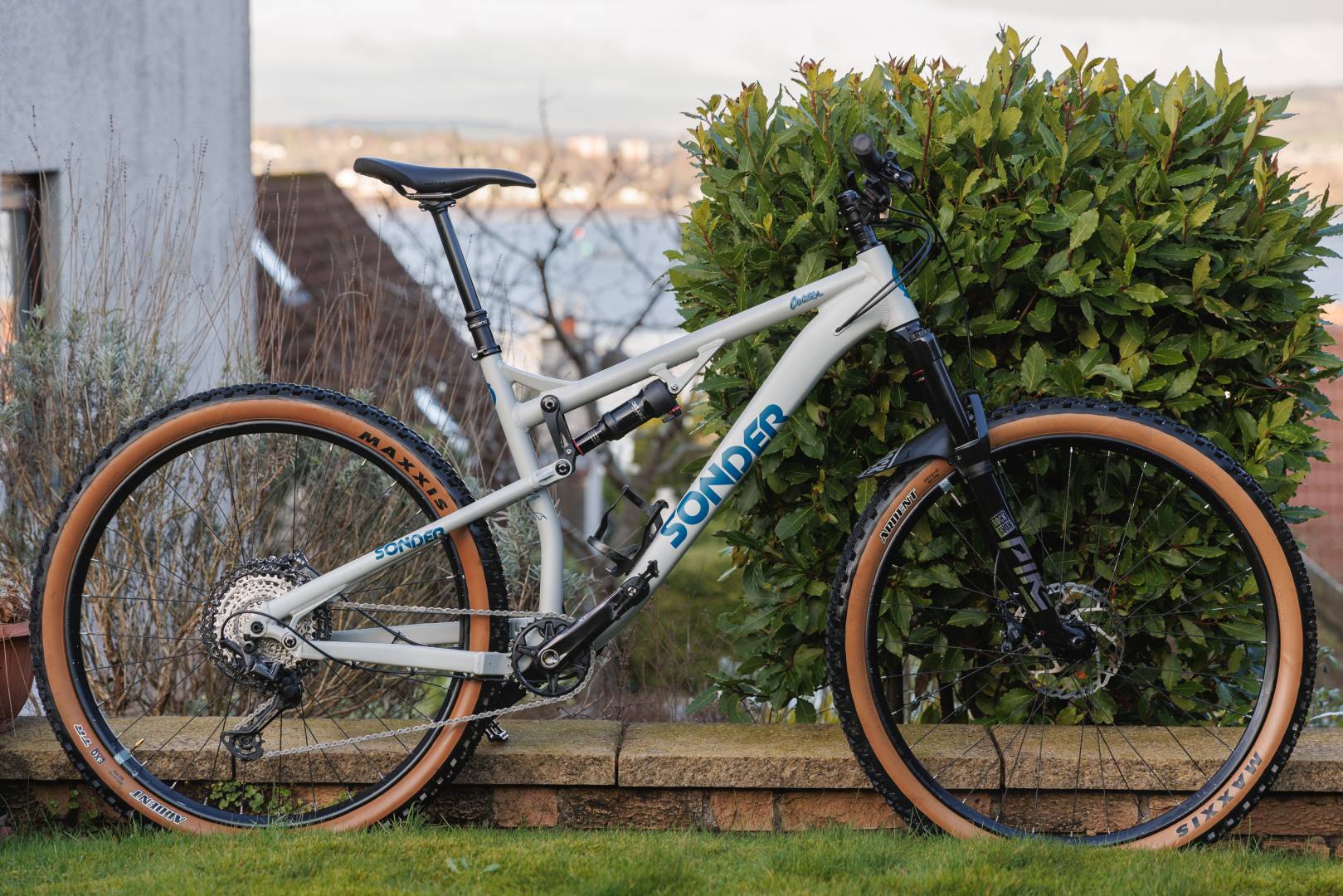

OP,  here. Sorry late update. I finally got round to finish this build. Sonder were very good in the end and found an excellent solution, which I probably can't make public 😂.
Anyway, surprisingly light at 28.5lbs (w/o pedals).
Select+ shock
Select+ Pike 140
Roval Controls
SLX + GX cassette
One Up V2.1 180mm
TRP Slate4 brakes
Wolfpack Cross 2.40 tyres
TAG carbon bars and e*13 stem
[img] [/img][/url]
