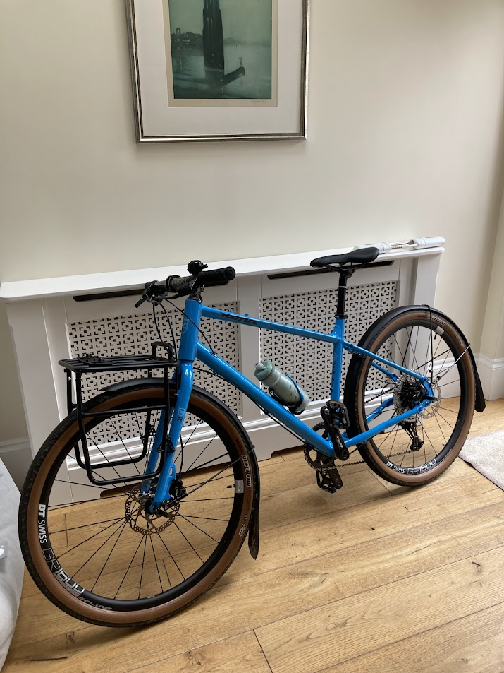

We have two Dews in the family collection:
The first is a Dew DL, an alloy model running factory Deore 11sp with upgrades including DT GR1600 650b wheelset and carbon flat bars.  These are only £550ish, with the obvious downgrades being QR 135 standard and Tektro discs.  Shared between me and my daughter, used on family gravel rides and occasional commuting.
The second is a Kona Dr Dew, steel with nicer parts based around 12sp Deore and 142 bolt-thru.  Pictured here before some upgrades including better tyres for offroad.
Both make very good flat bar gravel bikes.  They can be shorn of mudguards and have bigger tyres added easily, making them very much like rigid MTBs.
