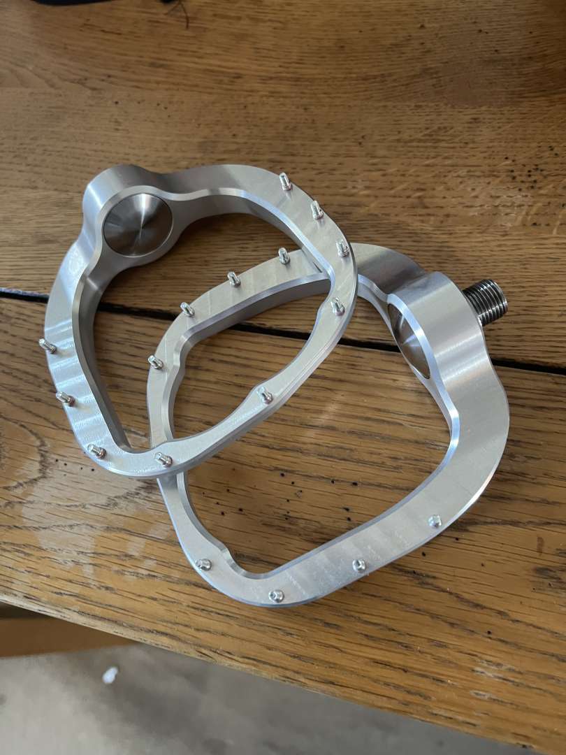

These arrived from far away lands this morning. Might be brilliant, might be shit. Will find out in a month or so.
Thoughts?

What shoes?
 With my Freerider Pros I think I’d miss the support. I had some Impacts with a much stiffer sole and they’d probably be OK.

I'd worry my toe box would get caught in that big hole !
Posted : 24/03/2025 12:08 pm
One for the John Wayne-legged riders, with those big nubs on the axle spacing your feet out?

I love the idea of them and the thought behind them makes a lot of sense to me. I was tempted myself. What held me back was the bearings. For the pedal to be the right way up when you need it, the bearings have to run very freely. I believe they use oil rather than grease. It likely also means very light seals, so my concern was longevity over a UK winter.

Shoes I’m not sure yet, as I need new ones owing to recent foot issues, any recommendations for the widest, deepest toe box much appreciated. Shouldnt have any issues with foot falling through as I’m well over the size 8 minimum recommended
Wide Q factor not an issue for me, had fat bikes and gearbox bikes, no issues with widely spaced pedals.
Total, landed, about £210, but fx rates are swinging in our favour at the moment.
initial impressions are they are super sturdy, (450g/pair) bearings super smooth and the pins (which are terrifying!) are always facing up, so not worried there, yet.

Yikes. My foot would clip those inboard bearings all the time. There must be huge twisting forces going through a high grime/ wear area? Keep us posted on how they work out

Rode them for a couple of days at BPW last week and right from the off, the shape of them is lovely. The bearing bulge sits right in the arch of my foot/shoe (Lake MX201, also great for those needing a wide fitting shoe) and the still, justifiably, terrifying pins - they have eaten my shins and calves from just pushing the bike around, no nibbles out on the trails though - offer a very concave shape, made all the more so without a middle bit of pedal. Once you are locked in, your feet are going nowhere, so the first few goes necessitated looking at them when setting off, and I was still doing that out of habit after 2 days riding. If you are coming from clips, you will have your feet much further forward on the pedals, so they are in the middle of you sole, rather than the ball of your foot over where the axle would be, in order to fit nicely. No issue for me, I've been on flats for the past 7 years, but something to think about.
Pedal strikes weren't an issue, reckon I had 2 or three over the couple of days, the shape of the underside shrugged them off and looking at the pedals, you'd never know. The lower platform definitely helped when things got rowdy, and pretty sure helped prevent an OTB when ambition outweighed ability and I hooked the back wheel on some big roots, I was thrown forward enough to lift the rear wheel, but not enough to send me out the front door.
The less than brilliant bit is the drive side bearings. The first day was wet, it having hosed down the night before and rained on the morning, but very much just puddles of dirty water everywhere (It seems impossible for me to go to BPW and it not rain, regardless of the time of year 😡 ) and to begin with everything was fine, the pedals were always right way up & spinning beautifully until the penultimate/last run were the DS pedal just had a little resistance, not enough for it to be a problem, but definitely there. Start of the second (dry, hurrah!) day and no change, just a bit of resistance. Anyway as the day went on there was more and more resistance until I had to spin the pedal with a foot to set off, not unlike SPD-R road pedals. I then get them home and it's serious effort just to turn them, I dismantle, clean as best I can and refit, better, but still that bit of resistance from the end of the first day. I've spoken to outlier and they aren't sure (and very apologetic), so waiting to hear if they want the pedals back, or they're just gonna send me some more (proprietary) bearings to fit myself. I really hope I've just been unlucky here (other, longer term, reviews you'll read will say they've had zero issues after 000's KMs) as the NDS pedal is still buttery smooth.
Overall, they are ace though, and I'll definitely buy another set once they've caught up on stock, assuming we can get to the bottom of this issue.

They’re a standard size, but the cage isn’t  metallic…
Posted : 29/07/2025 5:49 pm
Quick update, after a chat it was decided to send the pedals back for them for a look and  to swap the bearings for a fresh set, which they’ve now done and the pedals are on their way back to me, all free of charge and 10 days to do. Not ideal but dealt with pretty well, considering they are on the other side of the world.

Always good to see innovation in the real world. Pity about the poor sealing on the bearings though.  At the other end of the price range, I bought some HT composite pedals from my trail bike.  Work as well as my Vaults.
Posted : 13/08/2025 8:32 am
Posts: 18073
Thanks for the objective feedback, Tom. Think I'll stick with my quarter century old smashed up, pin missing but perfectly turning Shimano DX. Reasons:
The bulge would push my feet out and I like polishing cranks with my socks, those pins would make even deeper holes in my shins (do they really need to be that long? I've got a pair of DX with the short pins fitted and they still grip fine) , I don't want to have to visually place my feet.
A suggestion to the manufacturer: deliver with a set of shorter pins included in the box because there's no way I'd buy pedals with pins that long.

As I say, I think I’ve been unlucky, a few other people I’ve spoken to have loads of riding on them with no issue and on inspection, it was 1 of the 4 bearings that was gritty. I’ll stick a bit of grease around the seals to better protect them when they come back.
Posted : 13/08/2025 9:51 am
And they’re back, spinning beautifully.

Keep us updated. I usually smoosh a load of stern tube grease on sealed bearing outer surfaces. Under bolt caps, where there's an airspace and it doesn't affect rotation, to keep water out a bit longer!

Thank for the write up. I'm still curious about these but the heating issue is pretty much where my mind went when I first saw them.
Do you default to right leg forward when riding? Was the one bearing the outboard one? Theses other riders with 1000s I'm on them, do they ride in the wet?
Posted : 01/09/2025 6:15 am
Left foot forward, was the inboard driveside bearing that got a bit gritty.
Might just be bad luck then. I'd imagine the forward foot would get more of the spray..
Sorry, inboard is what I meant, the one most exposed to the spray.
