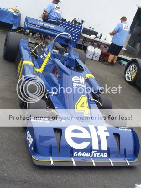

They did didn't they?
[IMG] :original[/IMG]
Posted : 22/03/2013 12:53 pm
That was before someone invented gearing 😉
