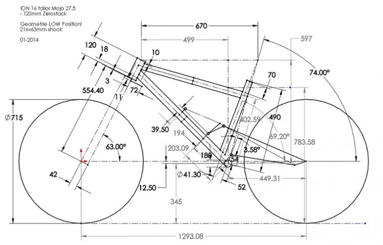

I can remember the exact date I first took notice...
https://www.pinkbike.com/news/nicolai-mojo-geometron-first-ride-2015.html
Posted : 17/11/2021 3:06 pm

 edd
Posts: 1390
I'm actually planning to sell my second batch (which means it has internal dropper routing) Geometron frame, size Long, at the start of December (when my Swarf 155 arrives). Looking for £600 posted with Float X2 shock (that needs a service), Hope headset, and seat clamp.
Geometry as follows:
Posted : 17/11/2021 6:25 pm
