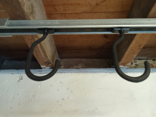

I decided to go for a sliding hook on a rail type system.
I'd long coveted the SpaceRail system which looks very slick but the set-up I'd need would be £1200 or so. Extra hooks are £65. They are very clever as they rotate around to let you store the bikes to & fro and it's a great looking system. Just not for my pocket.
Buller Ltd do a good system and £400 would have got me a good set-up in easy to order packages with everything included. Their hooks are £20-28.

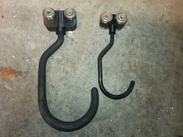

Then I found an eBay seller - rak.bike - who supplied the rolling hooks in various sizes & strengths for £10-15 per hook & advised you to source your own 41x41x2.5 slotted channel inexpensively.
Result! I ordered 6 regular & 4 heavy duty hooks then ordered 3.8m of slotted channel (3m & 80cm) & a joining piece & some bolts from Superlec.
On arrival, the standard hooks looked a bit weedy. Nothing wrong & they worked fine but I prefer having a bigger hook to hang the wheel on so I returned 4 & ordered 6 more heavy duty hooks. The seller was great to deal with & quick to refund me & send the new hooks.

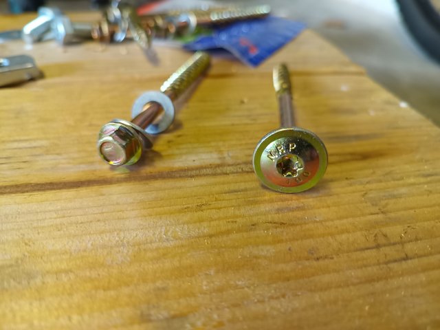

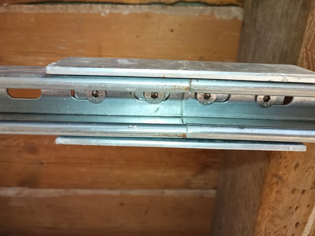

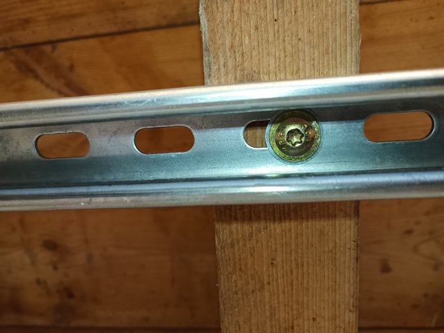

I put the rail up into the beams of my workshop then encountered a problem. I'd used M8 hex head self tapping bolts but the heads stuck out too far and the sliding hooks caught on them. I'd checked for clearance before assembly but hadn't factored that when you slide them they tilt a bit and needed more clearance. Rak.bike advised me they used flat headed fixings & were generally super helpful.
Seeing as I'd already made 8mm dia. holes in the beams I searched for M8 screws with flat heads & struggled until Amazon Prime sent me waffle head M8 versions.
That was it. Putting it all together was simple. You mount the rail according to the radius of the biggest wheel you'll be holding (29er) and go from there. I do have end stops to stop bikes sliding off the end but don't really need them as the sidewalls serve that purpose.

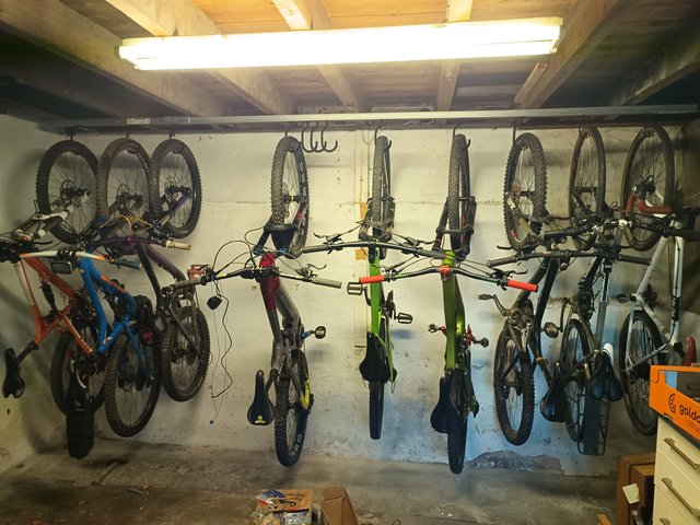

Being able to slide bikes together for storage then move them apart to get one out is great. I've got 12 on my 3.8m rail & could get 15 -18  if had to.
£170 on hooks. £30 on the rail, fixings & postage (£9 as it was so long). £200 total & Extra hooks can be added for £10-15.
Now to sort out the rest of the workshop...

What is the length required to hold 10 bikes?
Posted : 17/11/2024 4:52 pm
Posts: 2583
bikerevivesheffield
Well Rak.Bike say you can fit 9 in 2m but that's if you top & tail them & they have narrow bars I'd guess.
3m would be more comfortable for 10.
In the pic it's 3.8m & there are only 9 bikes up but you can fit a lot more.

What’s the length of the assembly to end of the hook? And your height from beam to floor? My garage didn’t have the clearance for the space rail system so I’m wondering if your version is any more compact?
From the top of the rail to the bottom of the heavy duty hook is 23cm or 17cm to the standard hook - which will still take a 2.4" tyre.
The bottom of the beam is 230cm.from the floor.
FYI the longest bike is a Haibike Nduro 7 (mullet) on a heavy duty hook & it has 11cm clearance between rear tyre & floor.

Posts: 6429

Is that rail not electricians Unistrut
That's exactly what it is. I'd never heard of it until rak.bike recommended it.

9 bikes in the space that used to contain 4

Right, another go. I'm intending to fit this over the holidays. I've ordered my sliding hooks from rak.bike only to find that not only do I vaguely know the chap who runs it, I work with this brother. I digress though. I've order the channel strut from ebay.
How do I correctly caulculate the size of screws I need to use to mount the strut? It'll be fitted in the garage which was built as an extension. The ceiling is fireboard (fireproof plasterboard) but thanks to some dodgy plasterwork over the fixings, I have a nice line showing me where the joists seem to run
2024-12-16 09.12.13
They seem to be spaced every 23 cm, more or less. The strut will be fitted behind where I took the photo, parallel to that line. One end will butt up against the khaki painted wall. I was thinking of just screwing into each joist using M8*120mm flat head screws if I can find some - or do I need bigger? Or is that size overkill? So I need fewer screws if bigger / more if smaller?
The local hardware shop has these
2024-12-14 16.41.45
Not sure if the heads on those might be too big, been looking for the "waffle head" scres that the OP suggested but without much luck, amazon has a few at M6 but none at M8 or M10.
Anyway, suggestions / feedback welcome please. What size screws and where from?

@nbt I'd be searching for coach screws. Available in lots of large sizes and easier to sink thank a screwdriver

@5lab cheers but the op mentioned how the larger heads on coach bolts foul the runners on the hooks

@nbt  I'm using 10cm wood screws with washers straight into the unistrut

@nbt I just found these whilst thinking about the same problem. Might be the right thing for you?
https://www.screwfix.com/c/screws-nails-fixings/woodscrews/cat840066?headtype=wafer

Having done some sums I've gone for 12*3" woodscrews with M8*25mm washers to hold them in place
Like this, but from the hardware shop in the village so cost me about a tenner
https://www.screwfix.com/p/quicksilver-pz-double-countersunk-woodscrews-12ga-x-3-100-pack/15055

been looking for the “waffle head” scres that the OP suggested but without much luck, amazon has a few at M6 but none at M8 or M10
They're listed as Wafer head on Amazon.
If I'd thought it through I'd have realised earlier that the line runs along s single joist, not across several. I got my directions mixed up

Posts: 3212
You're looking for structural wood screws.
They really don't need to be very long at all.
A couple of inches into the joist/rafter is all you need
https://www.strongtie.co.uk/en-UK/products/structural-wood-screw-sdw
https://tradefixdirect.com/c/nails-screws-fixings/screws/structural-timber-screws/
Posted : 21/12/2024 5:44 pm

Likewise.  I used 3" screws and even after drilling pilot holes, my 12v drill wasn't strong enough, i had to borrow an 18v drill from a neighbour. I tried my corded drill but Christ it's so heavy my arms would have dropped off.
I did mount on the joist but it was quite a way away from the wall.  Ended up using battens between the joists to get the strut in the right place. Even now i think i can move it another few cm closer but I'll leave it for the moment. I've got some of the bikes up there but not all: i need to move the wardrobe out of the way before i add an mtb, a road bike and a tandem. I might also change some of the small hooks for bigger ones, as i  struggled to get the bigger mtb tyres in the smaller hooks
IMG_4541IMG_4548IMG_4557IMG_4558

Good job nbt.
Your roof must be a bit higher than mine. There's no way I'd get a tandem on.

how well do the hooks roll over the channel joins? I think I'd need more than 3m of track, seems like its possible (but expensive) to buy 4/6m lengths of track but they're more expensive/awkward for delivery

No joins in mine, but we use similar stuff in the theatre for the curtain sweep tracks and as long as it's well fitted you really won't notice the join at all

When I joined two bits of trak together & ran a hook along it to test it was super smooth.
However, when I put it up & ran a bike along - it got stuck. The extra weight & the fact the hook gets tilted along with the profiles of the two bits of trak not quite lining up caused this. I took off the external joiner, hammered & levered the Trak until the bits lined up better then bolted the joiner back on being careful to keep it all lined up. Worked fine.
My link in the original post shows where I bought my Trak. Postage was £9. I bought a 3m bit & a 80cm bit but they did several different lengths. Got all the joining bits & end stops too. Very cheap.
