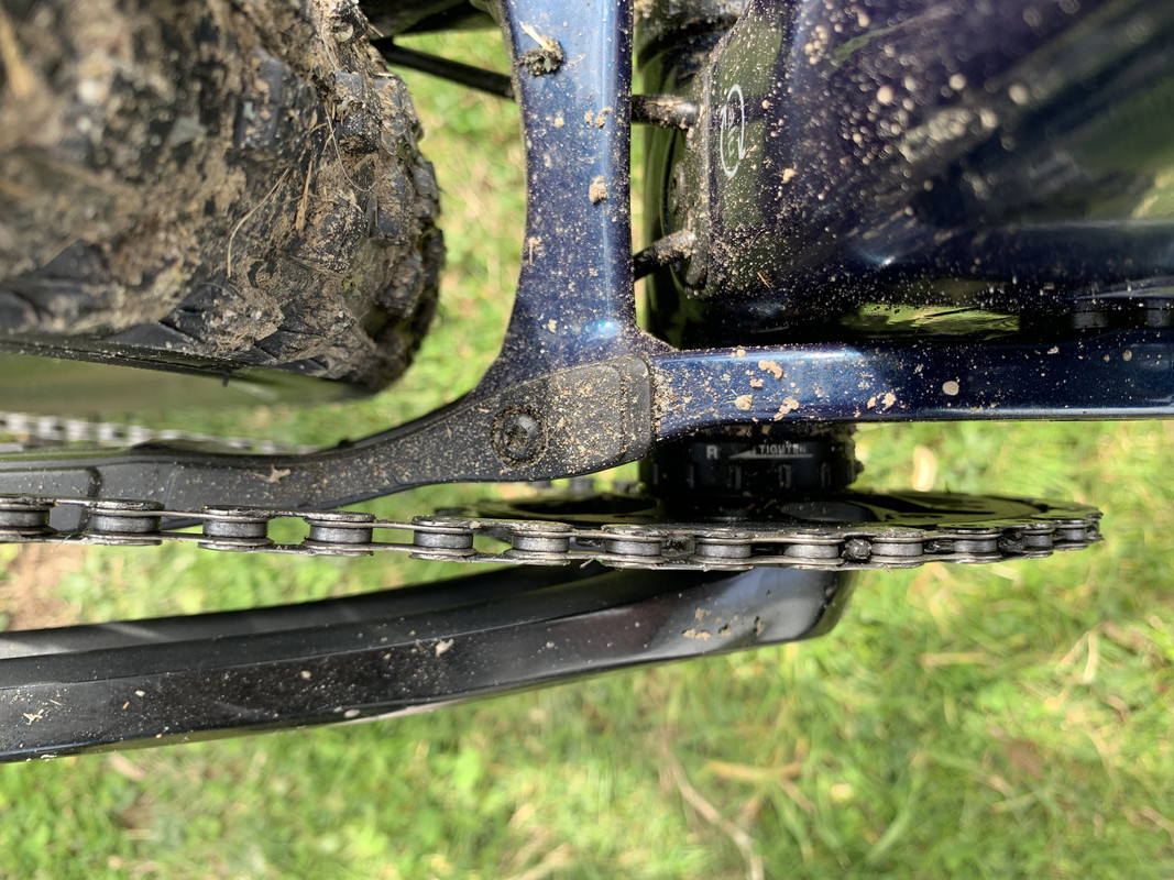

Thanks all. Does the ‘FC’ on the FC-M7120 from biketart mean anything fitment wise?
As for the chain line fitment. What’s the best way to check for clearance? It’s all alien to me! I can take photos if that helps to give an idea of clearance.

Posts: 1353
This is current clearance with 55mm. On the largest cog.

Posts: 258
Hard to tell from the pictures but with a M7100 crankset you will 3mm closer to the frame on either side, so measure the chainring to frame distance. With M7100 you will need to remove a 3mm spacer on each side. I can't tell form the pictures but you probably have to remove the BB cups to remove the spacers.

Posts: 10949
When I went from 7100 to 7120 the 3mm spacers are on the crank axle, not on the bottom bracket, one 3mm spacer each side of the crank. No need to remove BB cups. BB spacers remain the same for your frame BB shell width.

Posts: 3778
Yes - there’s no need to change BB spacers. The 52mm chainline option looks like it’ll clear as long as you’re not planning to increase chainring size significantly.
