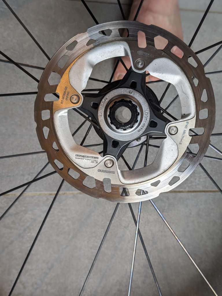

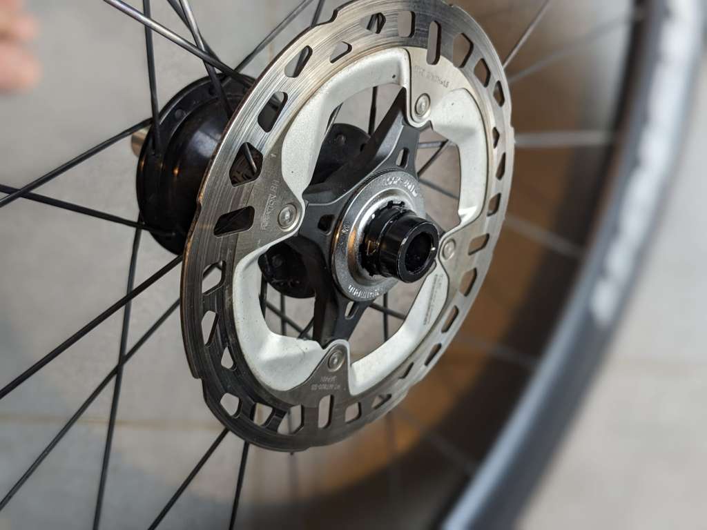

To go over an axle end cap that otherwise cannot come off, internal cassette lockring style

Surely this is exactly what externally splined lock rings are for? Is it to remove a badly specified one?

IMG-20231003-WA0017IMG-20231004-WA0027

That icetoolz one looks quite deep (deeper than my Shimano one anyway ) so I would give that a shot…

&£@?!! Well that’s a bugger.  Hammer, pointy drift and abuse some of that shimano branding?
