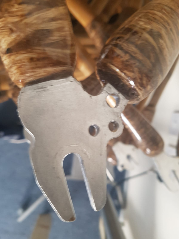

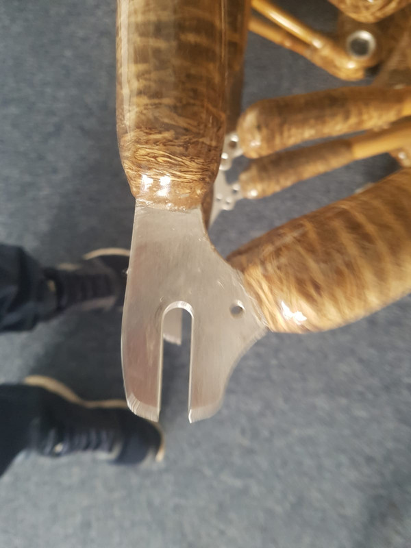

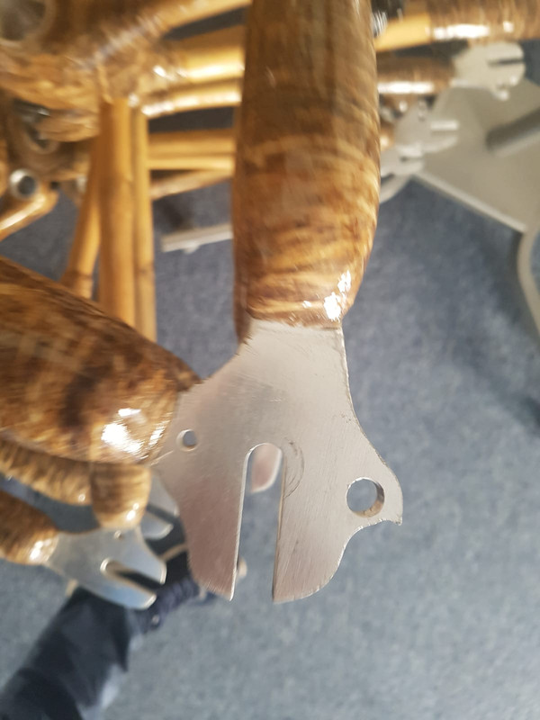

Am involved with a project to build up a number of frames (bamboo, naturally) for a local charity. We're in the process of sourcing unused bikes as donors, but a few questions have arisen.
The dropouts are sliding fixie style, albeit with a mech hanger. Will a standard qr hub work or will chain tugs be required?
Pictures, please.

Not my pics. I think most of the frames are like the first one. Is it possible to hang a mech hanger off the others?

Being pedantic I know, but that's slot dropouts, not sliding. If it were me I'd be using chain tugs.

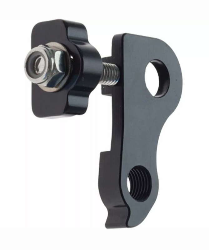

Chaintugs required. You can get some with a mech hanger on, yes.
Posted : 12/10/2019 7:13 pm
Posts: 1048
Like this?
https://rover.ebay.com/rover/0/0/0?mpre=https%3A%2F%2Fwww.ebay.co.uk%2Fulk%2Fitm%2F264439562116
Is there a cheaper option?
Posted : 12/10/2019 7:25 pm
