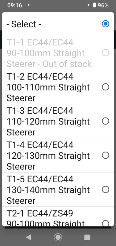

Think you can only get a 1 degree angle headset from Works Components for straight 1 1/8 headtubes.
linky

I have a 120 steerer tube with an external headset.
Will this fit?

It will if your headtube is 44mm but it wont if your headtube is 34mm.  What size is your headtube?
