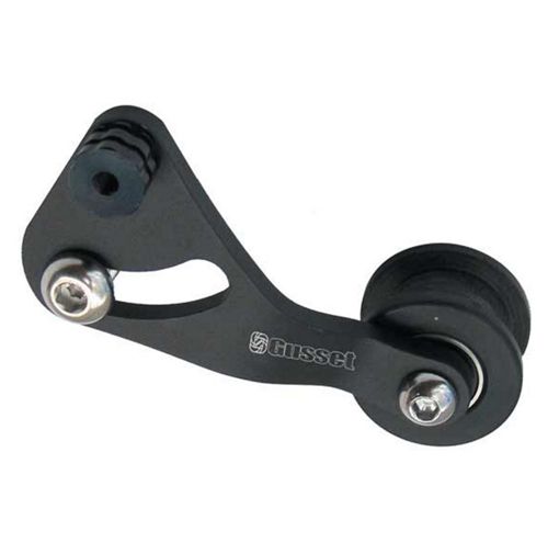

It’s a mountain bike but with slick tyres to be used for commuting so not rough terrain! So best option is buy than chain tensioner from the link above, get the chain as close as possible and use that?

yes - get the chain as close as possible and use a tensioner.  Personally I prefer a sprung tensioner as chainrings are always ever so slightly eccentric and chains can wear unevenly.

The chain tensioner was delivered today but I am a little to confused to how it fits to the frame?
Do do I use the old derailer hanger?
Posted : 10/10/2018 12:25 pm
Yeah, it's basically a derailleur sans the deraill-ey stuff.
Posted : 10/10/2018 12:31 pm
Depends what sort you have -
If you've got one of the style in TJ's link, then you fit to the mech hanger and run the chain under the jockey wheel, you then adjust the reach of the jockey wheel to match the chainline. If you got a one as per my link then the topnut replaces the nut on the end of your QR skewer and the other goes in your mech hanger hole and you adjust the tension by hand, with the wheel being a bit wider than a chain to account for varying chainlines.

@theotherjohnv yes it’s the one of Tj’s link, I have thrown the mech hanger away so will order a replacement!
The rear cog is spaced with a spacer kit.
