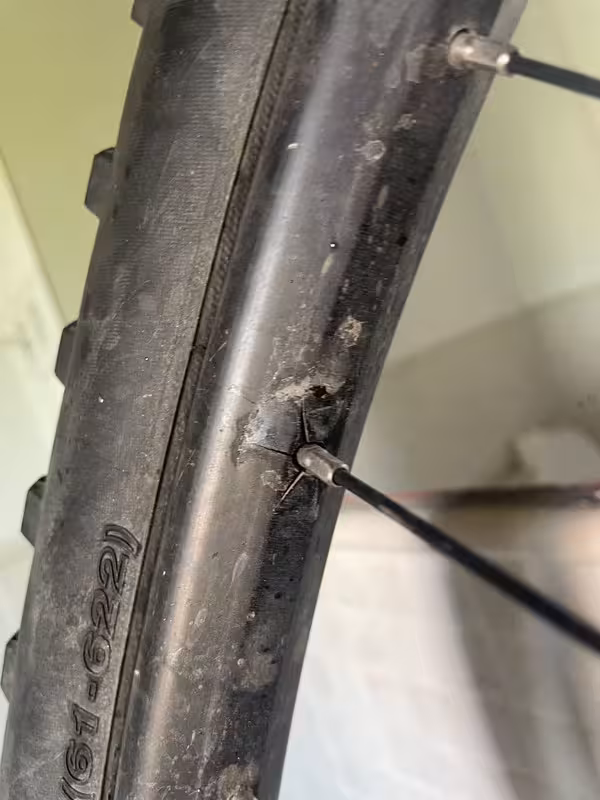

[url= https://postimg.cc/rDkySkPZ ][img] https://i.postimg.cc/g2wwbcqp/temp-Imagetx-KXy6.avif [/img][/url]

That ding doesn't look too bad from the photo. I fixed my hooligan son's Bontrager rim with one of these -
. https://www.amazon.co.uk/Wolf-Tooth-8-Bit-Remover-Multi-Tool/dp/B09JFC441T
(Then he really trashed it, now he runs Nukeproof inserts in a Deemax.)
Posted : 17/05/2024 10:03 am

The rim is toast actually, just saw several fractures in the rim around the spokes.
Posted : 17/05/2024 11:44 am

[url= https://postimg.cc/3WrB9DFR ][img] https://i.postimg.cc/HWXhYwJQ/temp-Imageo-CQ4-M7.avif [/img][/url]
Sticker?
Posted : 17/05/2024 12:26 pm

Will I die if I throw a tube in and ride around on those rims?
Posted : 17/05/2024 4:20 pm
Posts: 16346
The dent wouldn't bother me too much but that crack is a bit worrying and will add stress to the surrounding spokes. Fine for a bit of XC and riding round the woods. Massive hucks to flat maybe not so much.
Posted : 17/05/2024 4:30 pm
Posts: 927
yeah, there are cracks around the eyelets for 3-4 spokes, but the one pictured is the most unsightly.
Posted : 17/05/2024 4:38 pm
Posts: 16346
That's definitely new rim time then. If you want a pootle this weekend you'll probably get away with it if you go easy but I wouldn't do much more than that.
Posted : 17/05/2024 5:04 pm
Posts: 927
sounds sensible, thanks.
Posted : 17/05/2024 7:11 pm
