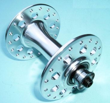

They also have these if OP fancies sticking with 126mm rear:
