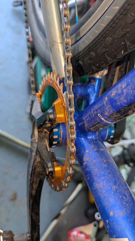

Posts: 11522
Ha, yes, now you mention it, using an oily rag to remove water probably isn't quite as effective as using a dry one!
This is my chain after getting home yesterday, hosing it off and running through a rag. There's actually more faint rust staining around the rollers than I had realised but it looks more like residue of dirty water than actual physical corrosion, I expect that will disappear once I reapply the lube (bearing in mind the chain is virtually dry at this point, not much lube left!).
