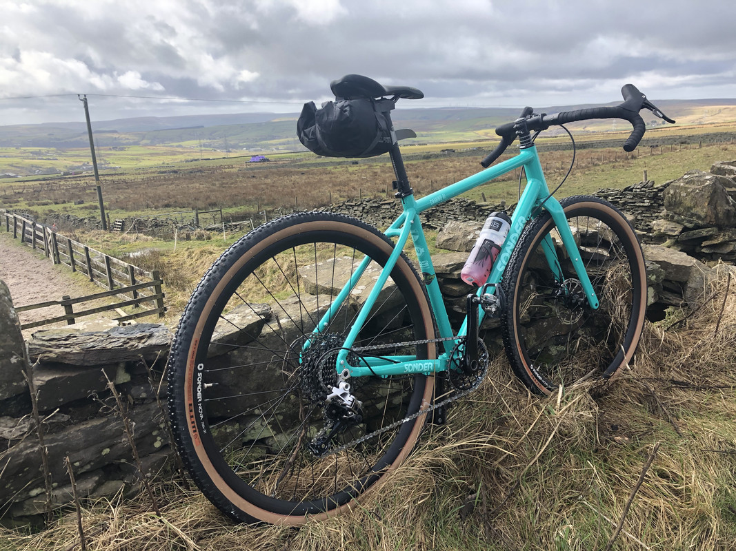

Arrived last Friday, upgraded to the Alpha wheel set and Tubeless tyres. GRX group set works flawlessly.
[url= https://i.postimg.cc/jSD9q8mb/IMG-2412.jp g" target="_blank">https://i.postimg.cc/jSD9q8mb/IMG-2412.jp g"/> [/img][/url]

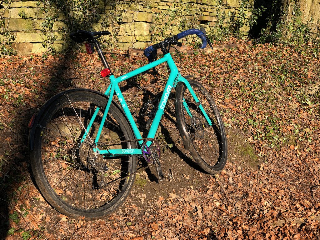

Here's mine, lovely and muddy 🙂
[url= https://i.postimg.cc/VLT8BWmR/20210312-170920.jp g" target="_blank">https://i.postimg.cc/VLT8BWmR/20210312-170920.jp g"/> [/img][/url]

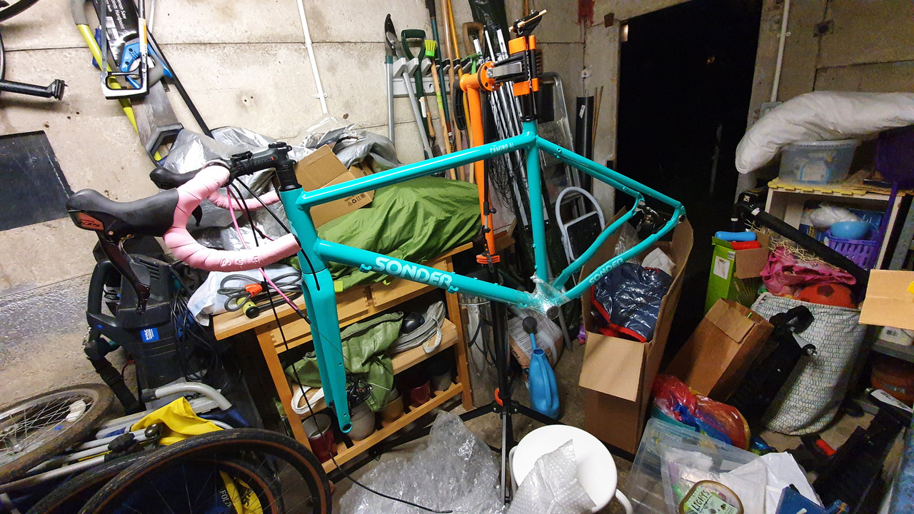

Camino part finished
Frame arrived a few weeks ago. Nearly finished, just a few of those annoying jobs to sort before I can test it.
The brakes arrived with the 'j-kit' setup which is bloody pointless, as if you need to shorten the hoses, you need to bleed anyway. I dont want those great big chunks of alloy dangling around on my hoses, so I've ordered a length of fresh BH59 and i'll bleed them properly.
I also had to swap my XTR front hub for a GRX front hub - I planned on using a 15>12mm axle sleeve but the actual endcaps would not fit in the fork without turning them down. So I have XTR rear, GRX front. At least the spoke legnths worked and I have an XTR desk ornament now.
And depsite working on an old bike, on this one, my rX mech wont clear the 42t so I've got a longer B-screw coming.
This was supposed to be a 'frame swap. The only part of the old bike I've used is the rear derailluer!
Its very nice looking though!

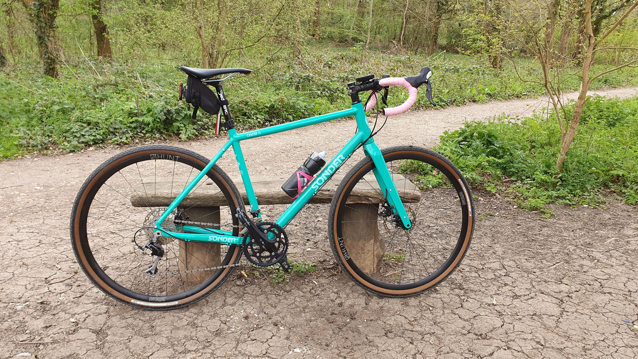

Here's the current state of mine, still got quite a bit to do.
camino
I'm trying to swap as much over but think I might need to lose the bar tape!
Also, the frame is a bit longer than the London Road it's replacing so I expect to replace the stem too. What length are people generally running? My old on was 100mm so thinking I might need to step down to 80mm or even 70mm. Going to build this up and see how it feels
Posted : 03/04/2021 7:47 am
Posts: 3002
I've gone for 70mm along with a Ritchey Butano bar which has quite a short reach and drop. Feels about right but its basically guesswork till I ride it properly.
