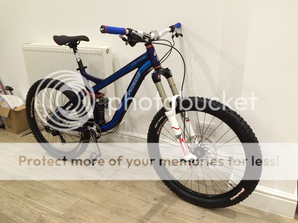

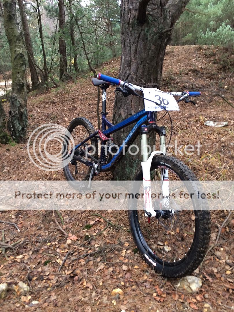

Here's mine (used to belong to tinas^).
I've built it lighter with 150mm Revs, 160/180 brakes, 1x10, specialized control casing tyres.
Use it for big days out, bit of Enduro racing and summer/dry local riding. Love it.
