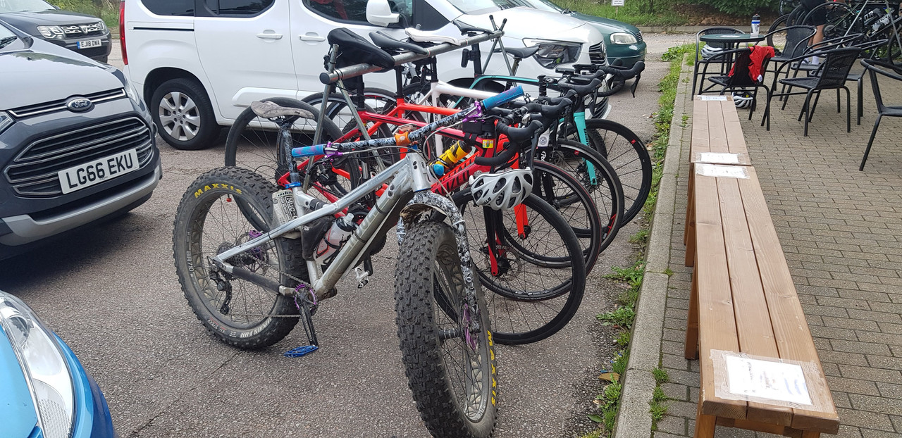

I have some diy front and rear mud guards made from old muc off bottles...they do OK but the mucky nutz gut fender is the real mud catcher...works great on my fatty
mud guards
