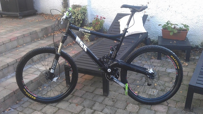

 ffej
My Meta 55
[url= http://farm5.staticflickr.com/4146/5027532880_57924abcf8.jp g" target="_blank">http://farm5.staticflickr.com/4146/5027532880_57924abcf8.jp g"/> [/img][/url]
Has changed quite a bit since then with new Revelations to replace the worn out Floats and double / bash / stinger rather than the 3 up front.
Jeff
Posted : 03/05/2013 7:50 am

Posts: 215
2008 Meta 55 - Stolen
[url= http://farm9.staticflickr.com/8551/8704541925_55be765b8d.jp g" target="_blank">http://farm9.staticflickr.com/8551/8704541925_55be765b8d.jp g"/> [/img][/url]
2009 Meta 55 - Cracked
[url= http://farm8.staticflickr.com/7161/6396204793_6b6ba519af.jp g" target="_blank">http://farm8.staticflickr.com/7161/6396204793_6b6ba519af.jp g"/> [/img][/url]
2011 Warranty replacement Meta 55
[url= http://farm9.staticflickr.com/8406/8704549251_86bc4a4bea.jp g" target="_blank">http://farm9.staticflickr.com/8406/8704549251_86bc4a4bea.jp g"/> [/img][/url]
At Antur
[url= http://farm9.staticflickr.com/8138/8704610149_d2294c7dd8.jp g" target="_blank">http://farm9.staticflickr.com/8138/8704610149_d2294c7dd8.jp g"/> [/img][/url]
[url= http://farm9.staticflickr.com/8542/8705723442_227231eb3b.jp g" target="_blank">http://farm9.staticflickr.com/8542/8705723442_227231eb3b.jp g"/> [/img][/url]
Posted : 03/05/2013 7:34 pm
