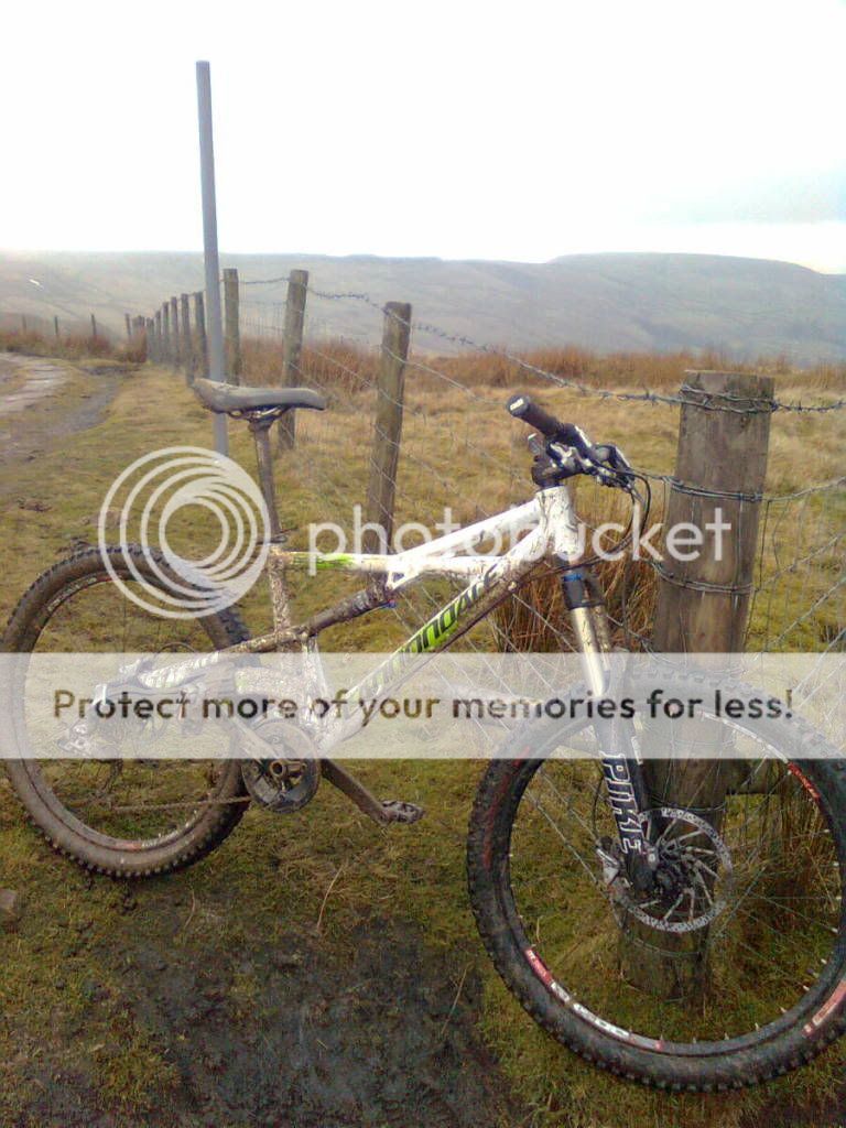

Here's mine. It's still got heavy 140mm Pike 409s on it. Would like to change them but not for more travel, just to lose some weight.
The forks, frame, headset and mechs are about the only original bits left from when I bought it new as a whole bike two years ago.
