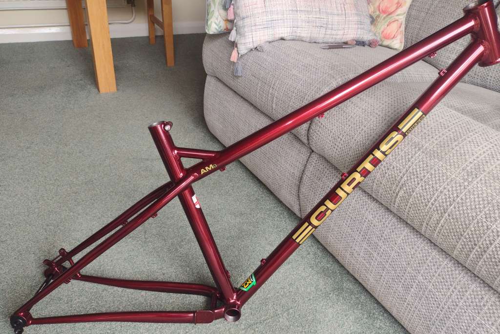

Posts: 4599
My AM9 , no shock required.

Posts: 3247
That Curtis has overtaken Joebristol’s Transition as the most shoehorned into threads about a totally different bike 😉

Posts: 2923
Not sure where you live oldfart, I'm sure it's a lovely bike, but as a main bike here it wouldn't be as good I'm afraid
