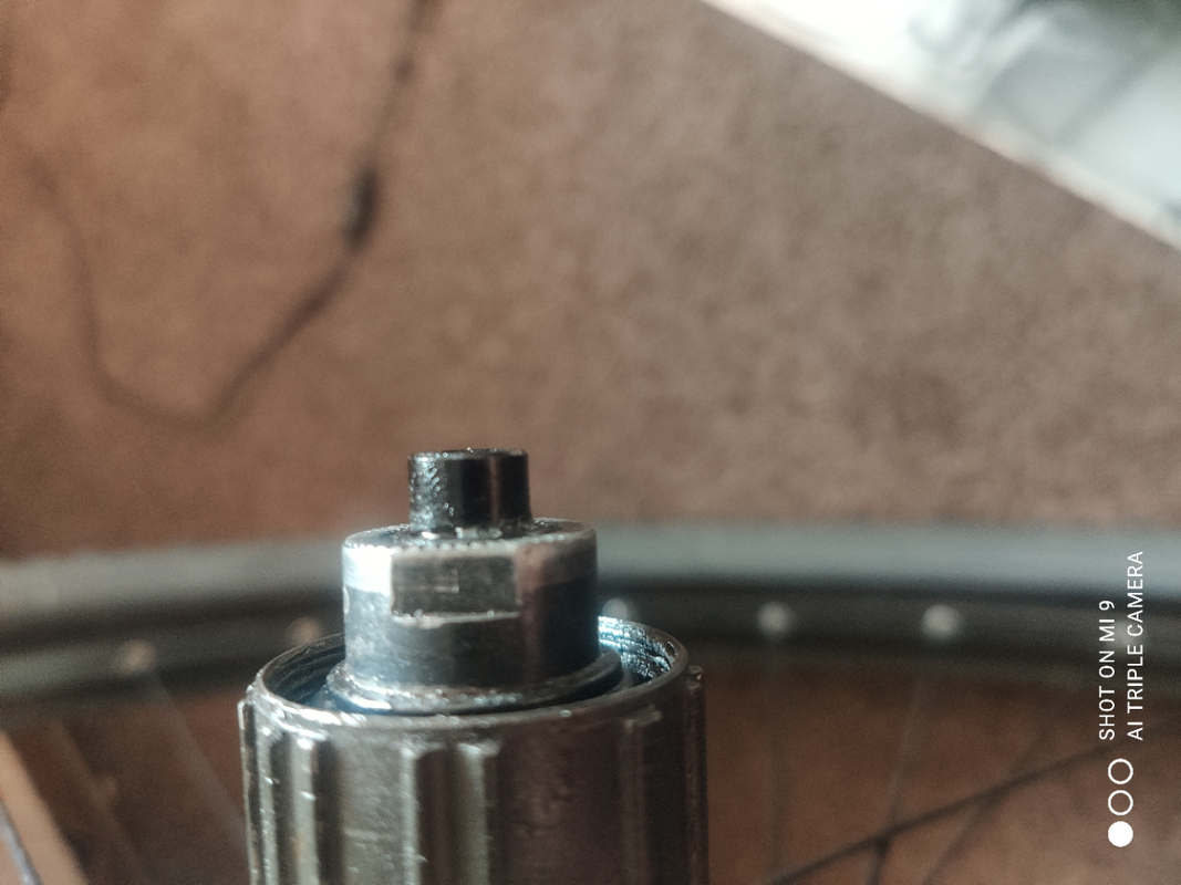

I could be wrong (been a long since having shimano hubs) but I don't think the shimano 12x142 is adjustable down to 135qr. The problem will be the internal diameter of your axle unless you know of any axles or push fit end caps that will reduce your hub down to the diameter of a qr axle
Have you got any pics of the end caps on your hub?
Posted : 06/03/2021 4:48 pm

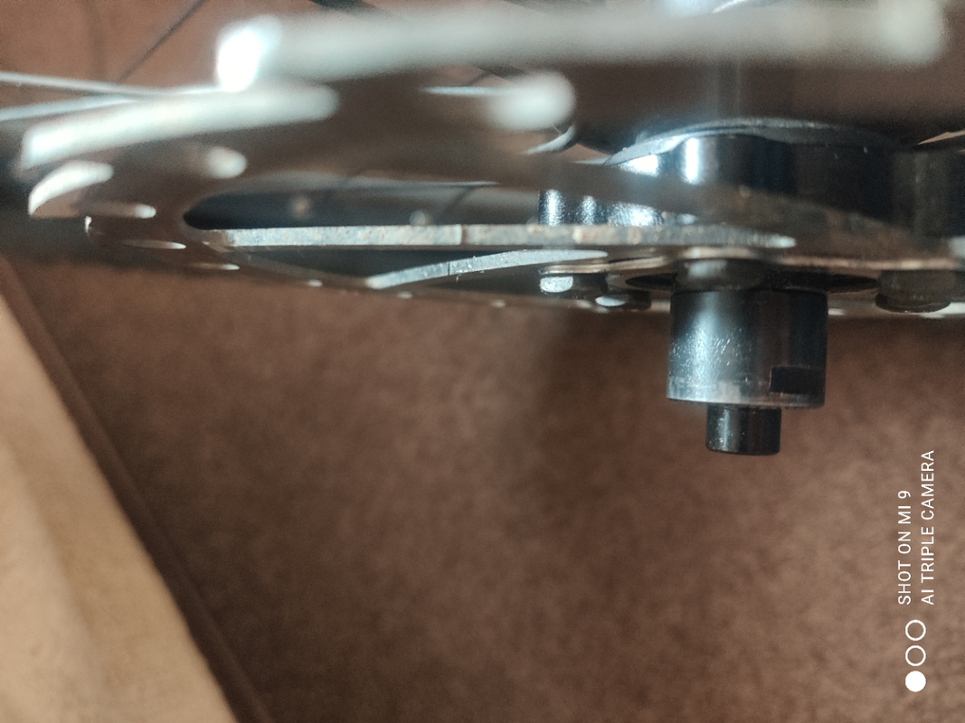

Thats with the 12mm to Qr adapter in which fits lovely , as you can see the end caps have a touch of silver metal on them and this is 3.5mm and after reading somewhere this was the difference between the two axle lengths
Posted : 06/03/2021 5:02 pm
Ah.. Didnt even know you could get those end cap adapters for shimano... I would presume(maybe wrongly) that it'd be better to cut the 3.5mm from the inside edge of the adapter which would leave the end bit to sit properly into the dropout. Is that something that could be done?

Just an update, 20 quid later and a trip to the engineers and I have a 135mm axle instead of 142mm, they also trimmed down the adapter and it sits in the frame perfectly...So if you get offered a 142mm wheel and your frame is 135mm all is not lost...
