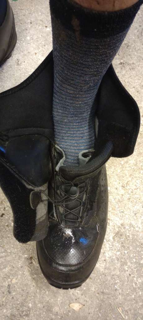

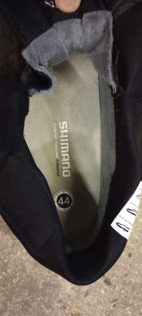

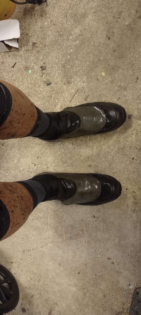

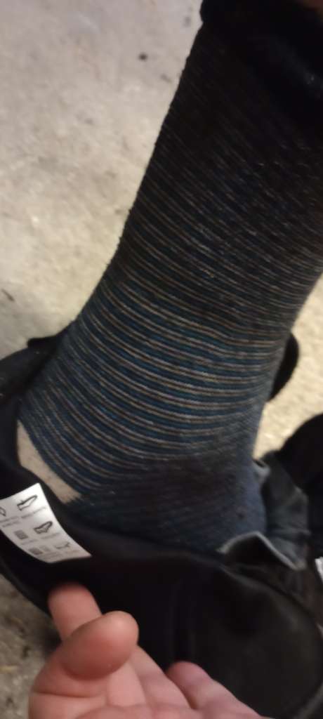

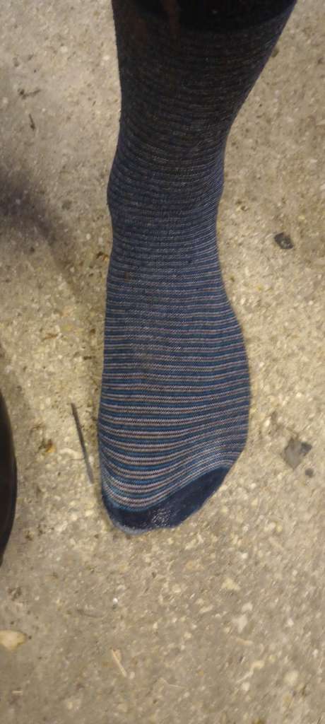

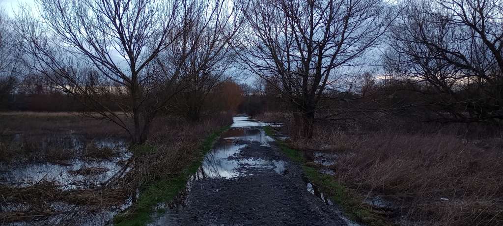

Just for this thread I decided to 'challenge' the water tightness of my MW5s and finished up my ride last night by pedalling through a couple of hundred yards of flood water:
IMG_20240211_165337683
IMG_20240211_170134517
IMG_20240211_170200662
IMG_20240211_170152803
IMG_20240211_170221160
IMG_20240211_170212109
So I'd say my foot got 'damp' not saturated and you can sort of tell how the water gets in. The tongue flap bottom edge has let a bit past to soak through the tongue (it is only velcro'd in position), and the vent holes on the toe box have probably been defeated a bit too. The wrap around neoprene 'collar' has gotten saturated and finally leaked through to my sock, but you could see the difference between the amount of water that had gotten in above and below that collar.
Where that water has gotten past by my heel you can see the insoles were a bit damp, but forward of that they were still dry, if I'd pedalled on for another couple of miles I'm sure more water would have soaked through though.
The instep area was surprisingly dry, and there was even a little dry patch on my sock just behind the top of the tongue (where the flap/collar overlap).
So yeah, not waterproof, and I wouldn't normally seek out a flood to ride through like that, especially if it had been colder or further from home, but for science I did and my feet didn't get as wet as I was expecting.
They've spent some time being blown on by a fan heater and are dry again now...
