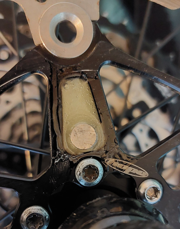

I got creative with a spare rotor and epoxy glue (Rise H15)...
Posted : 30/12/2022 2:34 pm

Loving the epoxy bodge.....might give that a go.

Not got a pic, but my mate epoxied his OEM centrelock magnet onto his 6 bolt upgraded wheel/rotor setup, a fair bit neater than that one above. Depends how bothered you are about it, but as long as there's a magnet there to send a signal, it doesn't really matter how it happens...
On bikes generally upwards of 5k. Having to bodge something like that is silly.
