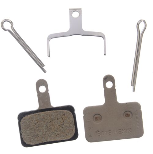

Having just made an eBay purchase for some R517 disc calipers, I went to check out getting some pads for them, in anticipation of the fitted pads being worn/glazed/contaminated etc etc.  I had assumed that as the majority of shimano pattern pads are the same (M475, M525, R317), that these would also fit into that group. and the pads would be the same as my M475 & M495 calipers.
It seems I may be wrong.
So, can anyone point me to somewhere that can confirm whether the R517 pads are/aren't interchangeable with the M475 type pads?

Posts: 1725
can confirm whether the R517 pads are/aren’t interchangeable with the M475 type pads?
They are a different shape so not interchangeable.
BR-R517 is specced with "Y8KA98010" G01S pads, which are the "newer" longer pads. Same pad shape as G02S, M666, M8000 etc in terms of fitment. You need non finned ones to fit the mechanical caliper. The new Shimano hydraulic road disc pads are different again, K02 shape.
G01S are resin, worth checking if your rotors are for resin pads only before you get sintered pads.
Old pads (M525 etc)
New pads (M8000 etc)
Posted : 30/04/2018 12:54 pm
Posts: 820
Thank you!
And Darn, I was hoping to have a full set of interchangeable pads across bikes.  Nevermind.  At least the newer pads appear to have a decent contact patch (might be as much as double my BB5 pads).
I'll be using Avid rotors so it'll be what it'll be on that. I think I'd rather have a more powerful, if faster wearing organic pad anyway...
And I was wondering about the finned ones. Not really needed on a mechanical set up anyway though, I guess.
Cheers, Much appreciated!
