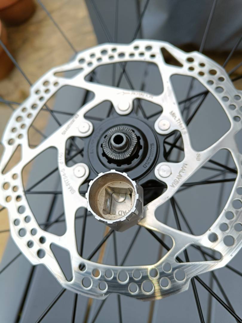

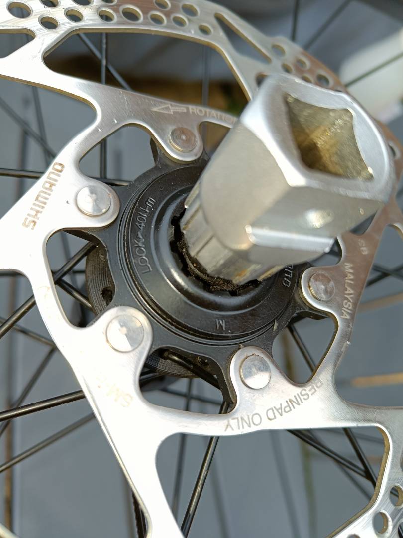

Thanks for the replies everyone. I notice that my links to pictures of the lockring+tool were removed but it seems I now have the ability to upload so here are some pics of the lockring tool and axle nut.
The issue isn't so much the depth of the tool but more the thickness of the wall failing to clear the axle. It's hard to see how there could be a lockring adapter with a thinner wall that this but perhaps I need to have a shop around.

that's a cup and cone setup? take the lock nut and cone out, keep hold of the bbs and you'll have all the space in the world
Posted : 10/03/2025 5:11 pm

Ah ok. That front rotor needs to get in the sea - generally, those low-end 'resin pads only' rotors aren't great. Better off with something like a RT64 (SLX level) that can take metallic pads, although for a smaller/lighter rider resin pads should still be fine. I've never had great success with those cheap resin-only rotors.
Looking at photo above, the locknut on the axle needs to come off for any tool to reach the splines on the locking. Once off, I'd swap to an external locking to avoid same problem again.

hmm thought i replied
looks like cup and cone, remove the lock nut and cone, take the ball bearings out and keep safe, you'll have all the space in the world then

Oh, and the hub was indeed a regular hub and cone so I loosened the opposite side to remove the axle to get full access for my lockring tool. Gave the bearings a good clean-down and re-grease for good measure and added the new rotor using an externally-splined lockring.
Thanks all for the help and advice!
