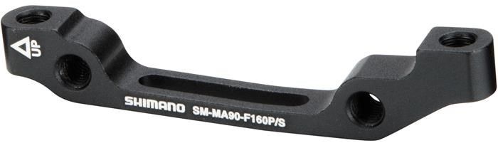

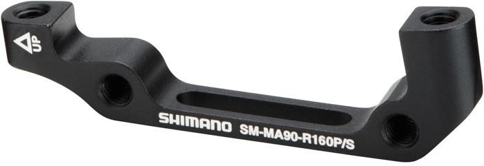

Is that the correct Post-IS adapter and is it the right way round?
See the difference in height?
Posted : 22/02/2016 4:07 pm

that did occur to me, but the front isn't using an adapter at all and is 160mm post mount and looks exactly the same...
we did change rotors (a little while ago) but was a straight swap for 160 to 160, and i dont think we did anything to the adaptor

Posts: 713
no markings of any kind on the adapter, but "looks" right and im sure we didnt change that when we did the disk
