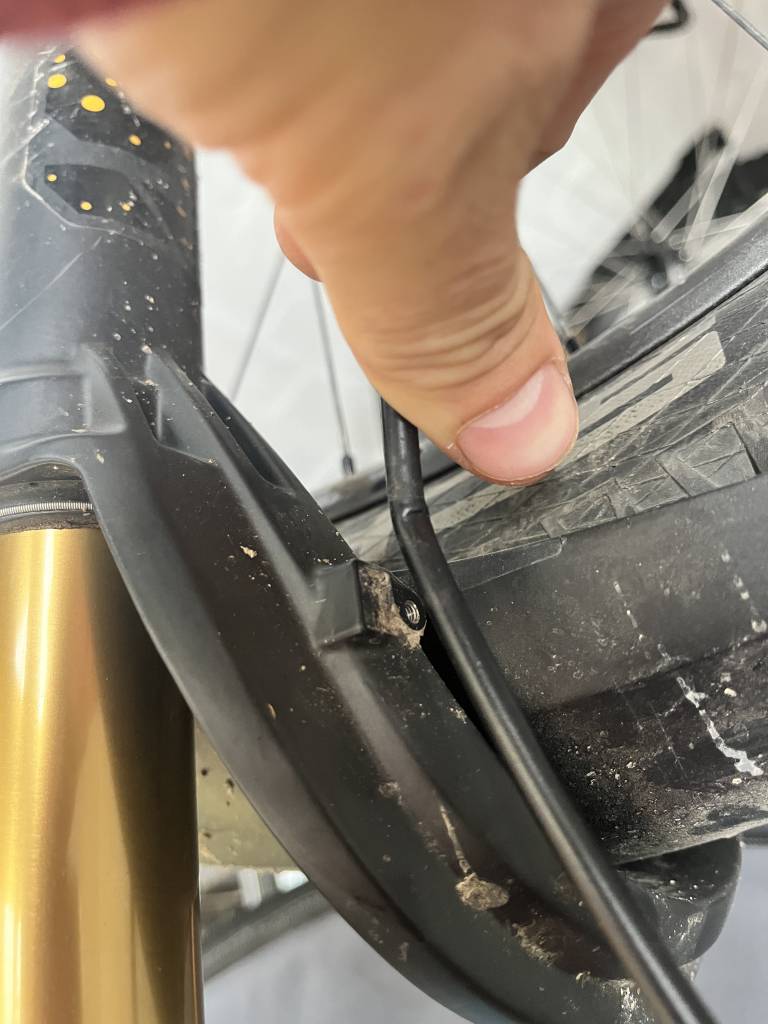

annoyingly also spotted the front hose is kinked just above the clamp on the fork, it looks like the bars have probably spun even she’s crashed at some point and bent it, so will get that changed. It’s one of those things that would either be fine for ever more or one day the hose will just split.
