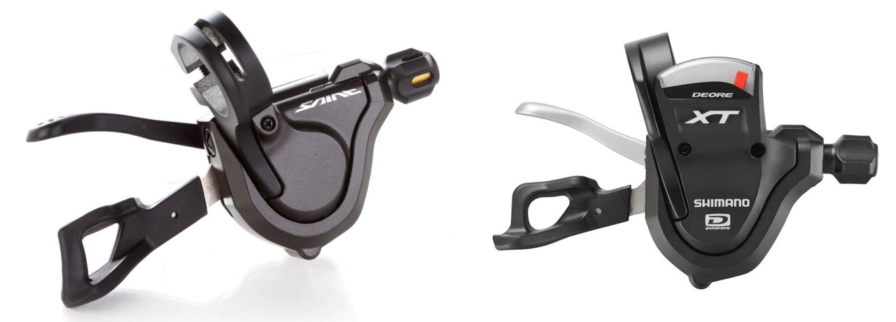

Rocketman might have the solution though, this looks good saint It has the slidy thing and looks quite low so might sort of sit underneath the master cyclinder bit of the lever. Is the Saint the longest paddles about? Or at least the longest Shimano one, I really don't get on with SRAM shifters.

Thanks, but it's not really the window causing the problem. I need to move the shifter right/outwards so that the paddle isn't underneath the master cylinder but because the clamp i outboard/right of the window the clamp causes a problem before the window does, basically the shifter clamp needs to be about halfway along where the lever clamp is. Longer paddles would definitely fix it, maybe 1/4-1/2 inch on the down-the-block lever, the other is OK. How much longer are the Saints?
You may be able to see the difference in this picture:
Saint - XT
The Saint paddles are a bit longer, a bit bigger and generally easier to operate
Posted : 06/02/2019 8:54 am
