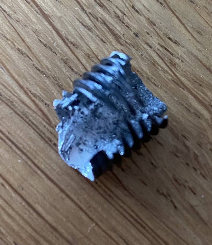

A friend kindly dropped around his P-X Free Ranger a few weeks ago for me to deal with a flat front tyre/seized thru axle - he’d borked the hex on the thru axle. No problem, inserted a thread extractor into the borked hex, heaved on the big adjustable spanner and the thread extractor promptly snapped 🥴.
OK, start drilling out the thru axle from the threaded end, concerned not to damage the thread - the end result is above - quite pleased with myself. The thru axle remains fast.
I’ve been reining blows on the remainder of the thru axle - in the hope it either comes free or the broken extractor pops out and I can get the drill out again.
Looks like my final option is to put a saw through the hub spindle, between fork blade and hub body - trashing the hub as it’s a relatively cheap Fulcrum Racing 900 wheel and I can’t find a spares listing anywhere ‘/ distributor has ignored my emails for spares info. I do have another spare hub and wheel if all else fails
Anyone share any other successful methods or know why P-X don’t grease thru axles on new bikes?

Got a picture of what's still left in the bike? Guessing if that's the thread gone, then it'll be siezed in the insert in the fork on the other end, in which case I'd try freeze spray, brute force if you can get purchase might end up spinning the insert in the carbon and a trashed fork.

The bike owner’s brother has the same bike and I had a look at the front hub a Fulcrum R900 - the hub spindle is effectively a hollow sleeve of unanodised aluminium alloy, so the corrosion will probably be all the way along. I’ve just bumped into the owner whilst out walking the dog - going to be taking a saw to it. I’ve got another spare wheel as it happens - it’s just my instinct to try and preserve the parts, at least the fork is still undamaged.
