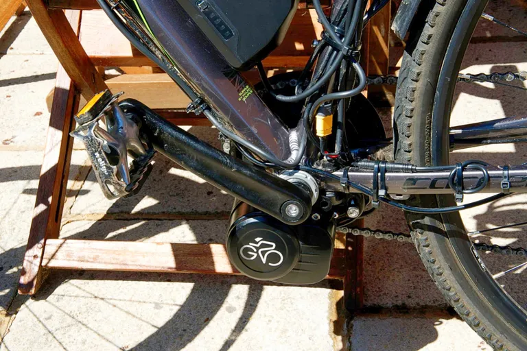

If I was looking at saving money on an ebike, I think I'd be keeping an eye out for a second hand Cotic full-sus (or other full sus with a relatively 'normal' downtube) and then buy a Tongsheng TSDZ2 kit to fit to it (the TSDZ2 is the only bolt on motor with a torque sensor, as far as I know).
It'll be a new motor and battery so that'll still be covered by warranty (although try to find a 'local' supplier). Plus, if it does crap out, at least you've still got the bike.
https://enerprof.de/en/motor-kits/motor-kits-36v/with-softpacks/1052/motor-kit-250w-battery-36v-15ah-softpack-in-frame-bag-540wh?c=205
There's a Cotic Rocket in the classifieds for £1300. Another £600 for the motor and battery (although I've no idea how the taxes would work these days) so that's less that £2K for a pretty decent set up. Not sure how that stacks up against a 2nd hand ebike.

This looks interesting...
https://www.indiegogo.com/projects/lightest-ebike-kit-your-bike-with-superpowers#/
Apparently comes with mounting plates to fit Bosch / Shimano etc.. mounts. They posted on EMTB Forums a while back showing it fitted to Bosch and Shimano. Torque sensing seems similar to Rocky Mountain PowerPlay.
Shimano
Bosch
Not sure what happens to battery / wiring / switches etc.

From my perspective it's mainly knowing if I can't replace a motor that the bike is not a brick.
I've seen some Bafang fitted as well with homemade mounting plates....
In a more perfect world it would be pretty and quiet but I'll take working over both.
Posted : 28/02/2023 11:15 am
Posts: 6762
From my perspective it’s mainly knowing if I can’t replace a motor that the bike is not a brick.
I’ve seen some Bafang fitted as well with homemade mounting plates….
In a more perfect world it would be pretty and quiet but I’ll take working over both.
I'm honestly struggling to see what the advantage of a built in motor is over a regular Bottom Bracket bolt-on one.

But that was really my point about the bolt on motors...
Posted : 28/02/2023 1:35 pm
Posts: 6762
But that was really my point about the bolt on motors…
I don't get it. It doesn't look to me like a TSDZ2 reduces ground clearance any more than an in-built motor, assuming you used something like a Cotic that had a straight downtube.
Posted : 28/02/2023 1:45 pm

I don’t get it. It doesn’t look to me like a TSDZ2 reduces ground clearance any more than an in-built motor, assuming you used something like a Cotic that had a straight downtube.
Not night and day... (as I said) but ground clearance is both more significant when the part smacking the rock/root etc. is potentially irreplaceable or very expensive AND tends to be lower.
I'm not saying don't... more something to consider. I'd say 165mm cranks are considered long on ebikes vs short on non-e
(I use 165mm on my real bikes as I'm a short arse so I'm always looking for short cranks and 90% of a typical eBay search will be eBike ones)
Posted : 28/02/2023 2:20 pm
Posts: 6762
Not night and day… (as I said) but ground clearance is both more significant when the part smacking the rock/root etc. is potentially irreplaceable or very expensive AND tends to be lower.
Another advantage of the TSDZ2, then. Whacking it and irreparably damaging it will only cost you 350 euros.

BruceWee
I'm not saying don't just things to consider...
The photo here from NDS doesn't look like its going to take a big bash well...
TDSZ2
Another view
