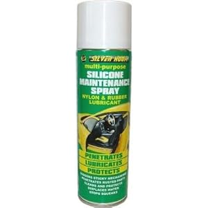

Deflate the tyres.
Spray silicon spray or similar or soapy water around the bead area.
Inflate to 40+ psi.
Leave overnight.
Lower pressure to what you want.
Sorted

This stuff is brilliant. Fit tyres, squirt on tyre/rim bead seating area, inflate to 20psi and jobs a good 'un.
Lower pressure to 8psi before you go ride though.

Thanks for the advice. Used soapy water and they went straight on. Egg shaped was a better description.
Will look into some silicon spray as well.
