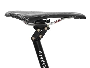

Posted : 27/09/2019 11:24 am
https://redshiftsports.com/dual-position-seatpost
null
