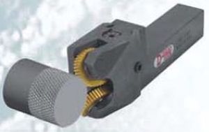

Sometimes hard anodising on the post causes this - in the past I've knurled the post to solve it.
Posted : 29/05/2015 6:48 am
Without trying to sound thick (and probably failing), how does one knurl a post?
Posted : 29/05/2015 8:38 am
Thomson post.
Bin it and buy something else. This issue comes up repeatedly on here.
Posted : 29/05/2015 8:41 am
Knurling
Posted : 29/05/2015 8:42 am
