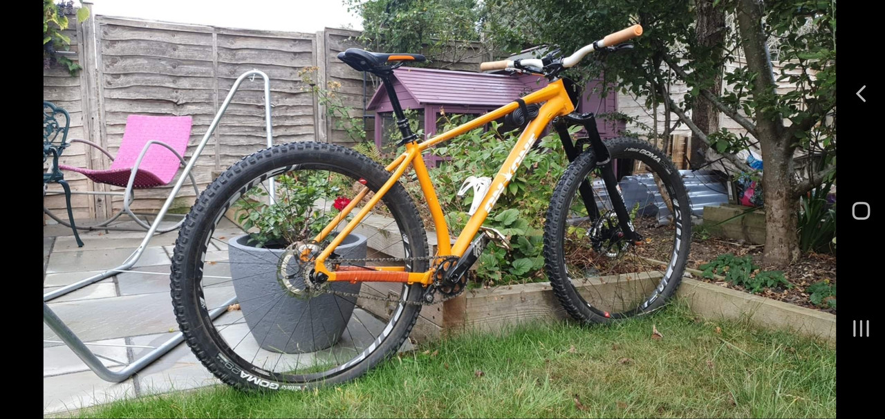

Looking to build up a single speed MTB for winter, milling about and half day XC riding
I have a spare set of brakes, bars and stem so why not build a bike around them?!
I have the use of a set of 27.5 single speed halo wheels with supadrive hubs for now
Where I’m driving myself insane is with frame and fork, I’ve been furiously looking around for a couple of weeks now to the point that I’ve looked at so many I don’t even know what I’m looking for any more
Ideally budget of £200 for frame, if I can get forks for that price too then I’ll call that a win
Someone…anyone…save me from insanity…tell me what small sized frame would make a beast of a single speed
Go…

The ss frames I can think of are 29er. Keep an eye out for a pipedream moxie or sirius- might struggle at that price though?

Brother Big Bro, Salsa Woodchipper, Spesh Fuse, SC Chameleon, Stooge?
Someone off here had a Big Bro in a rather smart gold if I remember rightly.

I’d keep an eye out for something like a second hand Cotic Soul or BFe, I got one in superb condition albeit as a 26” for under £200 which is now my commuter bike. Not single speed specific but I’m running it as one which a Surly chain tensioner which is great.

Keep looking for Kona Unit frames, they should all have adjustable dropouts. Also Singular cycles frames, all have EBBs, though much rarer but some come up. Think if you go with a tensioner you'll open up your options a great deal, there'll be plenty more frames in your size to choose from...

Genesis io frames are good I’ve had 3. Sure the frame can take 27.5 wheel too 🙂

If I get chance I’ll dig my io frame out attic(not for sale) I’ll pop a 27.5 wheel in and take pics 🙂
Posted : 24/09/2022 7:38 am
Posts: 1925
Ok it’s with boost rear so can’t get it in dropouts. 27.5 2.2 tyre loads of room even accounting for moving forward in dropout.
