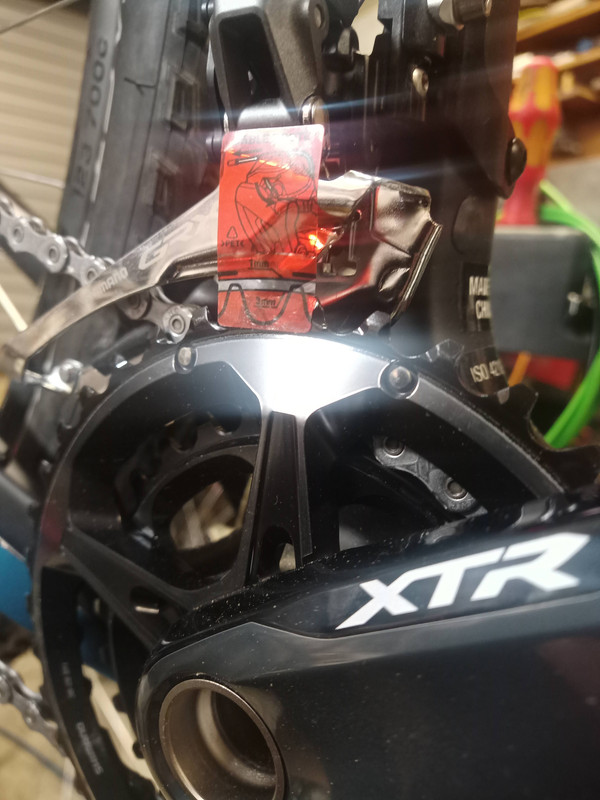

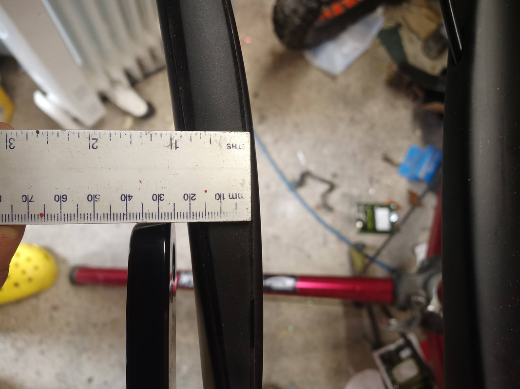

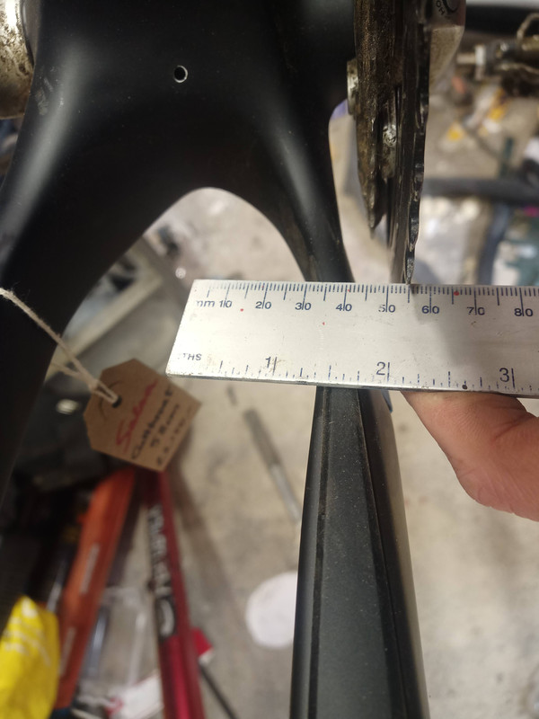

Salsa didn't help me either. Same generic response. I did my own measurements and took a punt
I can tell you that although it doesn't officially fit.
Xtr 28/38 fits and works a treat
Posted : 07/06/2023 8:22 am
Been running this set up for 6 months now. Works grand. Just be sure you locktite the nut holding the mech hanger/axle in place as it loves to come loose and is salsa proprietory - the lads at Lyon (importer) were really helpful

The answer is lots of reasearch and checking out q factors and mocking up with cranks I have and rings I have .
I have a hope 24mm BB in there
These are the 9120 trails rather than the 9000 race. They have a wider qfactor.
Clearance is tighter than I would like but after 6 months of abuse I'm not seeing any indications that it's an issue.

Almost forgot.
You'll need a front mech dropper. I use the zero degree bikingreen one off eBay for about 20 quid. It works grand.- I believe this is why salsa say 30/48 as the front mech physically won't go low enough
