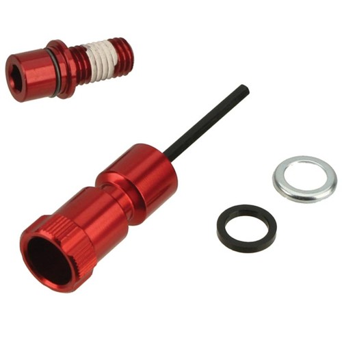

I've got the 2011 (I think) 150mm Black Box version of this fork. I tried adjusting the speed of the damping yesterday with the red allen nut on the bottom of the fork leg - illustration on the leg shows tortoise to hare. I was expecting clicks, but the nut just seemed to loosen off from a fully tight position - is this right? What's the deal for altering the high and low speed damping? Thanks v much for any advice and tips.

It sounds like the adjuster knob is missing - there's should be a protruding knob that you can turn by hand to change the rebound damping and locates in the nut you're talking about which should have a hole in the middle? They sometimes fall off as they're just a push fit on the nut/into the bottom of the rebound damper shaft.
If that's what's happened, you can still adjust the low-speed rebound using a 2.5mm - I think - allen key through the hole in the middle of the nut or you can source a new adjuster knob. The high speed rebound is non adjustable.

Should be something like [url= http://www.ebay.co.uk/itm/Rock-Shox-Rebound-Adjuster-Bolt-Kit-Red-Long-/221430103029?pt=UK_sportsleisure_cycling_bikeparts_SR&hash=item338e433bf5 ]this[/url] - sounds like you're missing the knob with the allen key type shaft protruding from it?

BWD - that's great, I think you're right. What a crazy place to use a push-fit part - mine probably disappeared within a ride or two. So is the high-speed non-adjustable even with the adjuster knob in place? It's just the low-speed I can tweak, and I need a 2.5mm allen? Not much point in me replacing the adjuster, a new one won't last 2 minutes either. Thanks for your help.
