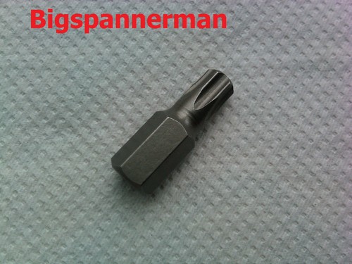

Best bet is a seperate torx bit from a screwdriver set, rather than a bigger handled tool- easier to hammer in, and more disposable.
Are you absolutely sure you need to get the cranks off? Best option is to do so obviously but it's often possible to thread a middle ring over the arms.
Posted : 26/09/2013 10:03 am
Something like this is ok, and disposable;
Posted : 26/09/2013 10:05 am
Definitely have some of those little fellers hanging around. I'll try and knock one in tonight.
