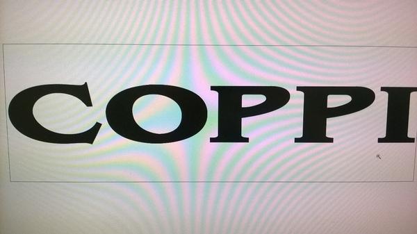

[img] :large[/img]
Tape
[img] :large[/img]
logo ref
[img] :large[/img]
redrawn vector logo
Now i get a stamp made and use a fabric ink pad and see how i get on... 😀
