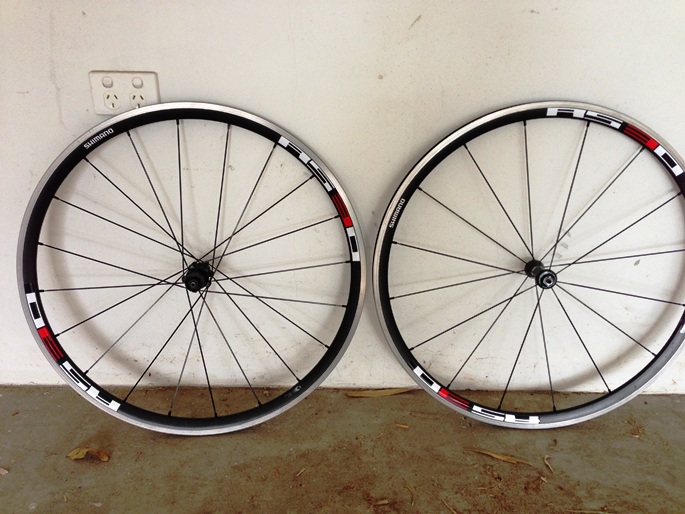

Shimano RS30's are what I use as my winter wheelset. They've been superseeded by RS31's now and can be had for £140 a pair. Ok not light but strong and alloy so will last a little while yet..
Blurb:
Shimano RS31 Road Bike Wheelset
•This RS31 clincher wheels offers aero performance and excellent quality at a competitive price
•30 mm high profile aluminium rim for improved aero dynamics
•16 front stainless steel butted and bladed straight pull spokes with a radial lacing pattern
•20 rear stainless steel butted and bladed straight pull spokes with a2-cross lacing pattern improve lateral and torsional (power transmission) rigidity
•Elbow-less spokes make for a strong yet compliant wheel
•High lateral rigidity is produced increased by wide flange spacing
•Smooth high polished finish hub shell
•The hub uses angular contact bearings designed to cradle the balls giving both radial and lateral support for superior strength and durability in real world riding conditions. They also offer precision bearing adjustment and easy maintenance
•Labyrinth and contact sealing - low-friction seals effectively shut out water, mud and dirt without affecting rotational smoothness
•8, 9, 10 and 11-speed compatible
•Supplied with Q/R skewer
