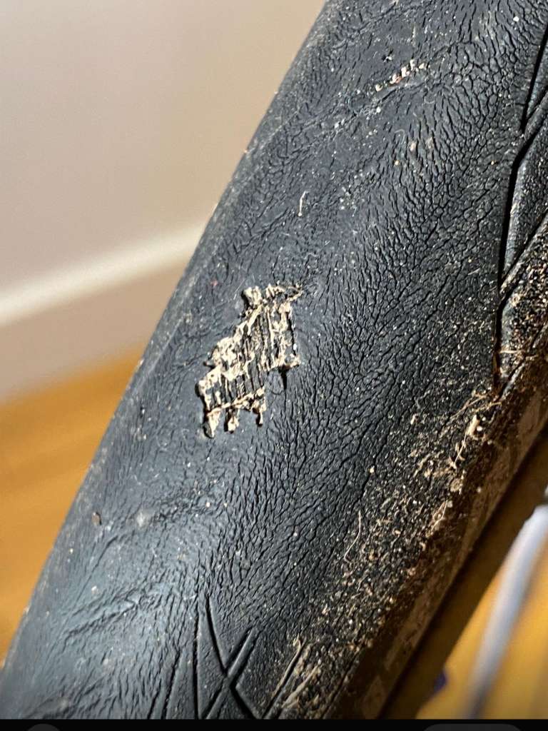

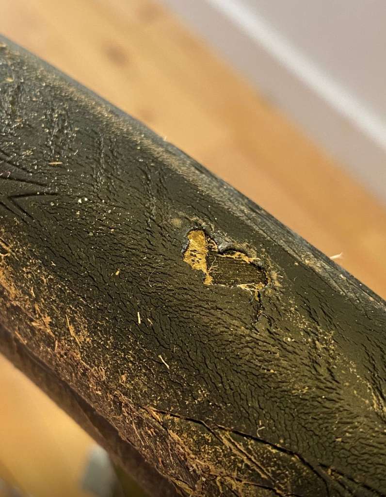

I’ve been running tubeless on the road for over 10y and 60-70k km.  In that time I’ve had only 4 punctures which didn’t seal themselves (albeit at a lower pressure) and only 1 for which I removed the wheel to plug.  Even in that case I could’ve done it on the bike, but I was at work and thought I’d do it indoors.  I haven’t used a road inner tube in over 11 years.  I’ve given a few away to people I’ve found stranded on my commutes/rides, but not needed one myself.
My rides are a mix of city, town l, cycle path, b-road and a-road along with a lot of country lanes.
Interestingly - I’ve had more punctures with the newer S-TR than the older TL of the GP5000.  I may go for the all road variants later.
My TLs were ran down to the canvas (over 8000km) and still weren’t getting punctured.
IMG_8462IMG_8461

Fitted carefully as per instructions, with barely a puff of air just to hold shape, by hand, no tyre levers or pinching.  Brand new wheels and tyres.
One leaked immediately from the base of the valve stem at a split.  One leaked at the overlap/joint and the other had mysterious pinholes around the inner face (rim tape face) despite no debris (new wheels and tubes, checked and wiped before install).
I wasn't inclined to send her out on the 4th so went for old faithful, which she completed coast to coast on with no issues.  Perhaps she'd have been a minute or two quicker with Ride Now.  Or an hour or two slower.  Wasn't worth the risk!
