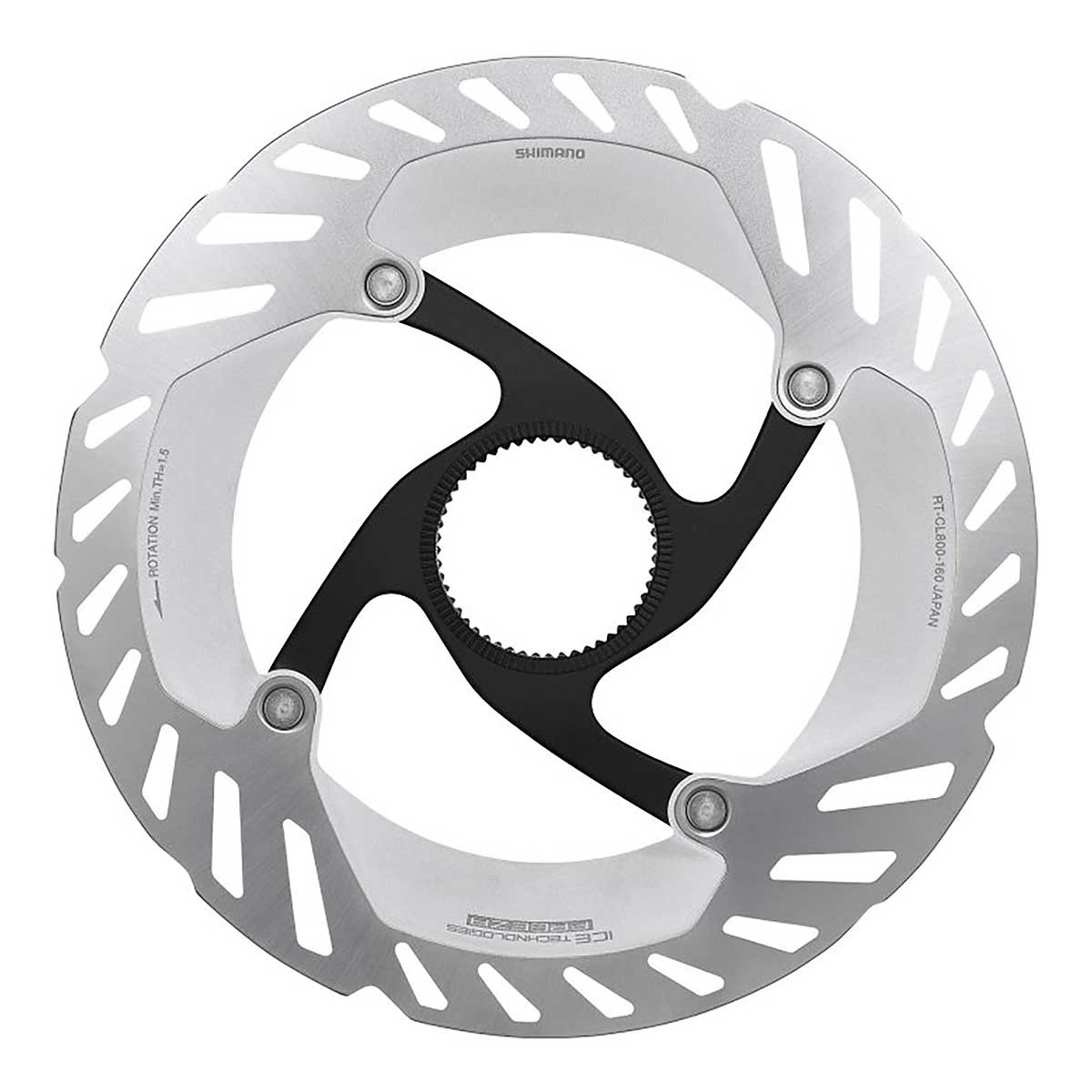

Brand new 105 brakes, some very steep hills around here, and a couple of times (where letting off the brakes to cool them isn't possible) the front disc has just crinkled up. Unexpectedly, a squirt of water from the bidon straightens it out perfectly but it's not ideal.
We're talking 20-25% gradients, easy enough to find another way but this never happened on my previous (c2017) 105-shod bike so I guess these discs are thinner. They're the SM-54 160 centrelocks - Worth changing the discs to another brand?

Aren't they the ones with the massive steel surface/spider plus tiny carrier?
If they are, either get some better cooled discs (i have some 160mm ultegra level ones with cooling fins that i've not managed to get to rub) or bigger ones the same (plus the adaptors).
And TBH, they all do that, to one degree or another, eventually. Just depends on how well centred they are and what the clearances are. (And how hot they get.)

OK, I'll try Ultegra. They're 30€ more expensive, but I guess I only need the front one. It's just weird that my old bike never did this, bought new with 105 kit but just threw the cheapest replacement on when the rotors wore out. Did brakes get more powerful? Or did I get fat? Lol

Well Ultegra rotor ordered, see if that cures it, I can reuse the old ones on my commuter . The pads are finned on 105 already but the rotors appear to be junk. Had more confidence on these hills when I was riding rim brakes with cork pads and explodey carbon rims.

Avoid Shimano Warp-Tech rotors altogether would be my advice, I've had more success with cheaper 1-piece Shimano rotors, or SRAM spider-ed ones.

I've had it a bit with Hope rotors - the ally spider deforms and goes a bit dished. Not helped by the breaking surfaces on mine being right close to the wear limit and I really need to replace them before winter.
The Shimano Ultegra ice tech ones on my gravelbike are woeful for going out of true and rubbing. I think its because they're a fancy steel/ally/steel sandwich, so there's relatively little structural integrity to them, especially once the steel starts to wear a bit. I haven't actually properly tacoed one, mind...

Those rotors are only for resin pads - is that what you have fitted?

As Daffy says, those are for resin pads only so if you're using anything else, I'd expect trouble.
The resin only shimanos are just stamped steel and in your case, bolted to a small alloy carrier.
Higher spec Icetech are a full alloy core with a stainless braking surface bonded to the core.
Cheap stamped steel will warp. 'pensive alloy/ stainless ones won't warp anywhere near as easily so your Ultegra should fix your problem.

What actually makes those rotors resin pad only? The shape of the cutouts? Lower quality steel that pringles?

Yeah, basically lower quality steel that pringles. Metal pads are a lot more aggressive than the resin.

not even 105 rotors TBF. resin only deore M6000. 105 are SM-RT70. I put centre lock XT rotors on mine. only paid £20 for each of them.

Anyway, Ultegra rotor on, 50€ poorer, and we'll see if we can warp it.
